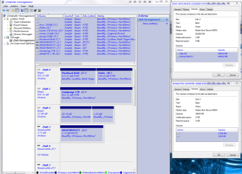

screenshot of my drives showing the kingston ssd drive which has linux kubuntu on and saying it has MBR
my main drive with windows 7 also showing it has MBR
this is where i am confused
