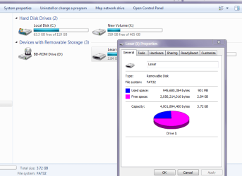

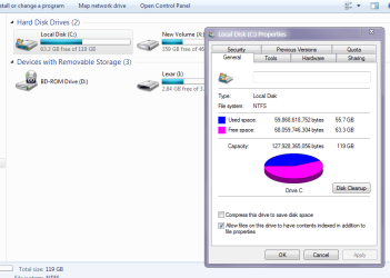

Ok Madeline I understand why you nee so many now - sorry I wasn't being nosey just it seemed a lot of ports to be used.
NOw before you do that if you can getthese devices hooked up to another machine can you check the files system they are using.
To do that > Start > Computer > right click on a drive > click on properties it should say whether it is a FAT32 or NTFS see my pics the FAT32 is one stick I have in and the other is my C: SSD drive - NTFS filing

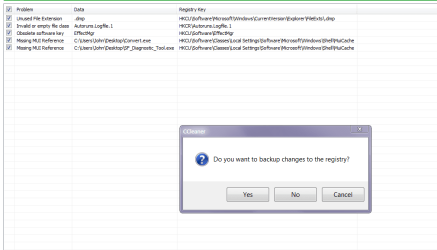

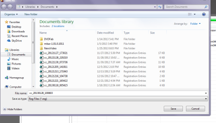

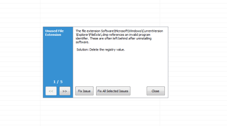

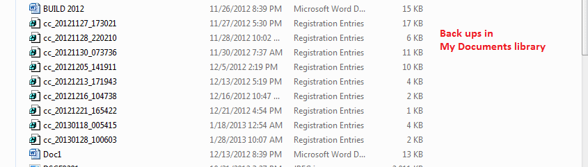

Yes Madeline I do but I always back up the reg before I apply any changes - it gives you that option before you do that and the back up is stored in My Documents usually - if you need to reverse the changes you click on the Documents entry and it will reapply the changes but I have never had to do that. Piriform - Registry cleaning is some info on the feature as well as other stuff
This is is the only reg cleaner that I will ever use but it is always down to ones own preferences. In any case using a reg cleaner of any sort needs caution at all times as you will see in my pics I did just a while ago the entries are files that are obsolete / invalid / or missing files that I just ran the cleaner for as they were of little consequence but I still backed up first.
The CCleaner I use far more frequently than the reg feature.
