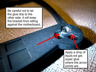

I have a Thermaltake Water 2.0 Extreme water cooler, made by Asetek. they are sold under several brand names, Corsair, Antec, and others, but they all have the same backplate bracket. It uses metal threaded inserts, they call them grommets, which fit through the bracket and into the motherboard. The water pump/cooling block then mounts with screws through the inserts.
Sometimes when removing the pump these inserts will spin inside the soft plastic bracket and it's a royal pain to get them out. I think I have come up with some help for that. Before installing the backplate use some super glue, liquid type, not gel, as shown in this picture. It is a relatively large amount of glue, so let it cure for an hour or so.
I have a backplate this happened with, after removing it I used super glue on the spun inserts and it held them fine during the next removal process. Also I recommend not using a screwdriver to tighten the mounting screws, but rather finger tight. IF using a driver then stop when the screws bottom out, that is enough.

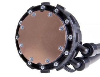

The pump. Some have fan connector cables as well.
Sometimes when removing the pump these inserts will spin inside the soft plastic bracket and it's a royal pain to get them out. I think I have come up with some help for that. Before installing the backplate use some super glue, liquid type, not gel, as shown in this picture. It will a relatively large amount of glue, so let it cure for an hour or so.

Absolutely Gary that is the exact problem I had with the Intel cooler backplate and as Brian says I shroud have used finger tightening only . I blame part of the problem on the poor fittings instruction booklet put out by Intel in that is was very small print and I cannot remember reading to only use finger tightening and so ended up using a small screwdriver in the tightening screws because they had the slots for one in them.
This resulted like you with those same shaped fitting nuts spinning in what I think ought to be a fixing collar with little more substance in it - again a minus mark for Intel.
My fix I used a small drop of five minute two pack resin based glue that sets extremely hard reaching full cure in 24 hours but can be used after ten minutes and provides a greater area of grip around the retaining nuts on that collar.
All in all and I think you might agree that for the money we pay for these devices one really does expect a better quality product than they are - or at least I do.:huh:
