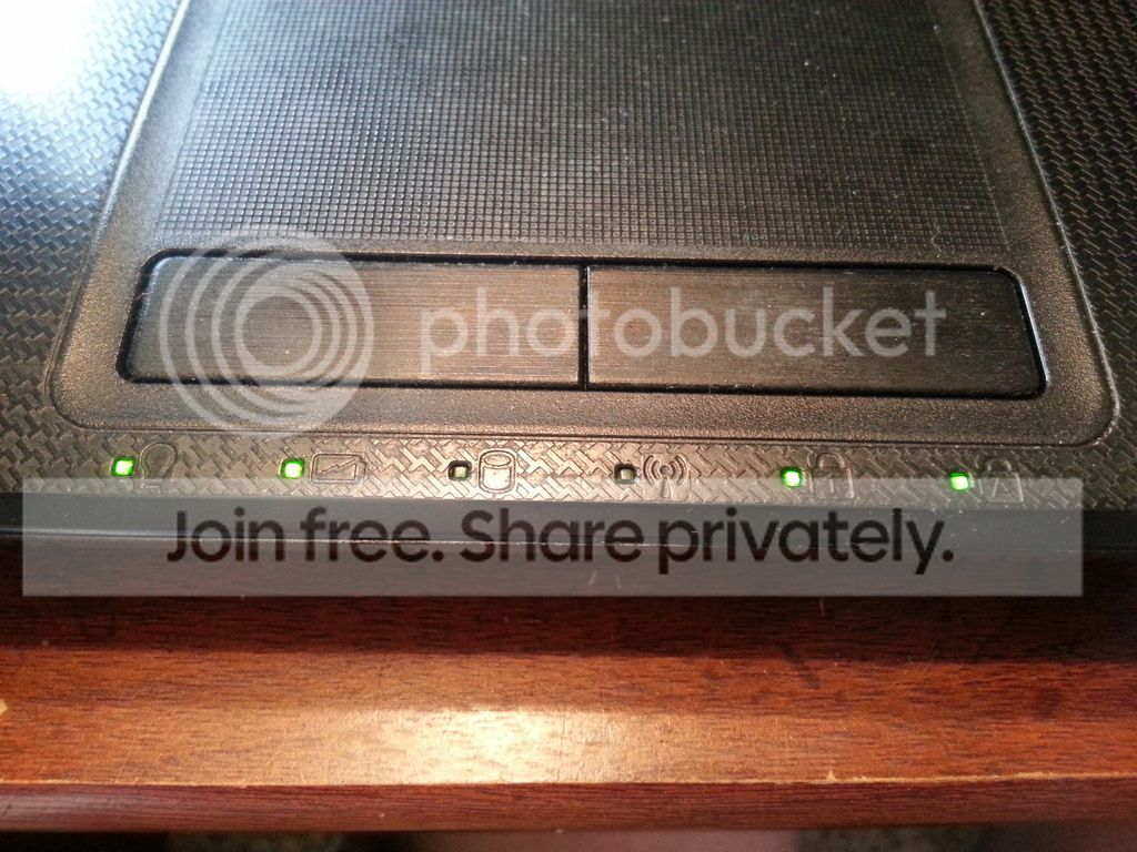

When the power button is pressed the fan turns on and some indicator lights turn on including the hard drive indicator light. Then the disc drive makes a noise and the hard drive indicator light turns off. Here is a picture of the indicator lights:
Nothing ever shows up on the screen.
Sometimes after running 1-5 minutes the laptop will just completely turn off.

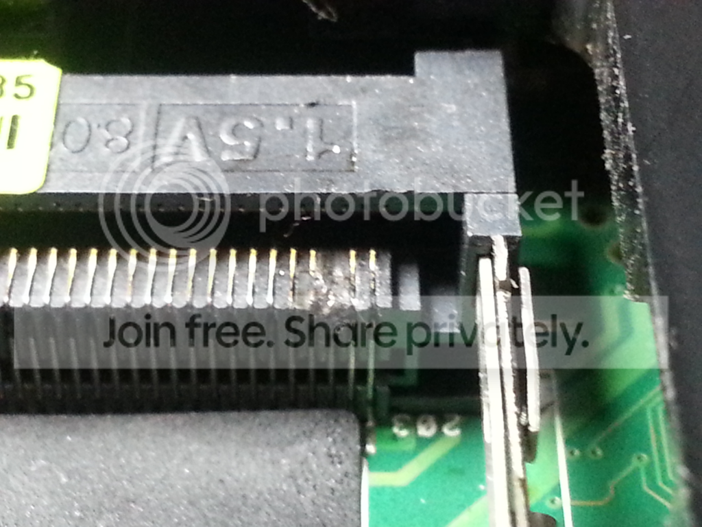

-Replacing the current stick of ram with a new one from crucial.com. This laptop only has one RAM slot and I don't have any compatible RAM so I had to just buy one. I put it in, and nothing happened differently. Also, if I remove the RAM completely nothing happens differently. This made me think that there might be an issue with the RAM slot. I looked at it, and there seems to be something a little weird about one of the connectors. Here is a picture:
I am not sure, but I thought that this might be causing the RAM to not be detected. I used a voltmeter to test between the trace of the RAM and where that connection goes into the motherboard, and it seems to be good (not certain though).

The 3rd fin on the right side of RAM slot looks like broken. Is it the case?

Yes. Would that cause issues? On the RAM there are connections on both the top and the bottom. Will a connection to either side work or are both sides a different unique connection? On the slot, the top fin is still good.
