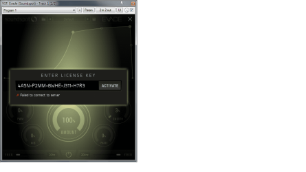

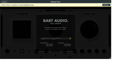

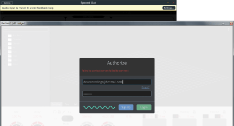

I've had this problem for quite a while, firstly I thought it was the recieving end's fault, and then it happened on some other software.
As shown in the pictures below, when I am trying to authorise some vst/software, wether in my DAW or standalone, it says there is no connection to the internet.

That's the first thing I did. They then sent me the stand alone version which also had problems authorising.
As shown in the pictures, baby audios plug in isn't the only culprit.
There is also software I've authorised in the past which now no longer allows me to use because of this issue (also shown in the pictures)
Like previously mentioned, I don't have any firewall on, but it's something in win 7 as when I try authorising on win 10 it works.

Make sure TLS 1.2 is on under Internet Options. To do so follow my instructions:
Go to the Windows Control Panel | Internet Options | Advanced tab and scroll to the bottom. See screenshot.

OMG!!!! YESSSSSS!!! OMG!!!
Litterally can't express my gratitude for your reply!!! OMG!!
Thank you so much!! OVER THE MOON!!
Have the best weekend!! .. Man, thank you so much!!!
YeSSSS!!!!

F22 Simpilot, Not sure what's going on. As shown above, the baby audio vst worked however the other two still aren't able to authorise :(
Any other suggestions? :thumbsup: (Once again though, thanks for the previous reply! At least the Baby audio VST authorised! :D):party:

First, make sure you have SHA2 code signing ability. Do you have update kb4474419 installed? If not you can install it from here. Last two entries of:
2019-09 Security Update for Windows 7 for x64-based Systems (KB4474419)
and
2019-09 Security Update for Windows 7 for x86-based Systems (KB4474419)
If your Windows 7 install is 32 bit you'll want the one that's x86.
Try the install again for those programs after a computer restart. Still no dice? Maybe it's a certificate.
I have uploaded a massive registry file for root certificates called ROOT_CERT.zip. It's from Windows 10 and I verified the entries to another source on Github via compare and contrast software. Before you install do two things: 1) Make a System Restore point. 2) Run my batch file attached here called cert reg export.bat. That batch file will place a registry backup file from the certificate store on your desktop.
After that extract the registry file from the zip file and double click to install. You'll get a warning about adding to the registry. Now restart the computer (very important) and try to install those two programs again. If this still doesn't work you may have to ask a senior tech at these two software companies what kind of connection the authorization software component makes. Because that's key in knowing why the connection is failing. If they use nothing but TLS 1.3 for example it may be game over trying to authorize the software under Windows 7. Unless some kind of "hack" wrapper or proxy can be used to trick the connection into thinking you're using TLS 1.3 when you're not so that you can install with your Creds. I just don't think TLS 1.3 is possible under Window 7, and if it is it's a some kind of hack I'm sure.

Remove or blot out the Info. in the above two screenshots. Your license key and email are exposed...
Thanks so much for taking the time to try and help me.
I have done the procedures mentioned. One of the vsts 'redverb' authorises, The other 'evade' doesn't.
I actually think there is a problem, or the company doesn't exist anymore as when I try to open their website, it's always down for maintenence.
TBF , a while back I did email them with the problem I've been having and they never responded, and since been dowe for maintanence.
