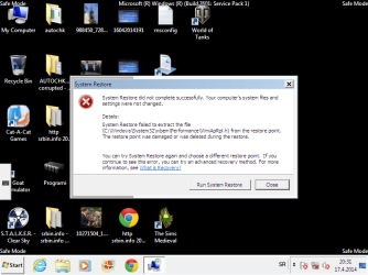

ok,now all that is left is problem with system restore here is the screenshot of error message
