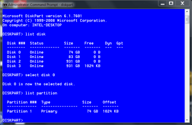

The easiest way to check alignment is to download AS SSD benchmark tool. Open it and select your SSD. Dont run the tool, but look in the top left corner it will show the firmware, the driver and the alignment. The alignment must be divisible by 4.
The other way is to open an elevated command prompt
type diskpart then press enter
type list disk -enter
select disk # where # is the number of your SSD
type list partition
you will see a listing of size of the drive and an offset size. The offset is your alignment. it should look like this
The AS SSD should look like this. In both cases my alignment is 1024​
