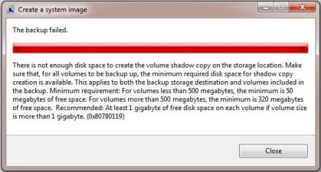

I am trying create a backup image of my Win7 OS on a system that has these drives:
DISKPART> list volume
  Volume ###  Ltr  Label        Fs     Type        Size     Status     Info
  Volume 0     J                       DVD-ROM         0 B  No Media
  Volume 1     I                       DVD-ROM         0 B  No Media
  Volume 2     D   Win          NTFS   Partition    154 GB  Healthy
  Volume 3     G                NTFS   Partition    143 GB  Healthy
  Volume 4     E   Games        NTFS   Partition    298 GB  Healthy
  Volume 5         System Rese  NTFS   Partition    100 MB  Healthy  [COLOR=red][B]System[/B][/COLOR]
  Volume 6     H                NTFS   Partition    297 GB  Healthy
  Volume 7     F   Application  NTFS   Partition    298 GB  Healthy
  Volume 8     C                NTFS   Partition    119 GB  Healthy  [B][COLOR=red]Boot[/COLOR][/B]
  Volume 9     K   PATRIOT      NTFS   Removable     29 GB  Healthy
The available space for the volumes listed varies from 29GB (K) to 218GB (F), the backup requires 25GB available storage to complete the image creation. No matter which drive selected for saving the image, the backup fails. The error message goes a long way about not enough disk space, please see the image below...
Creating system repair disk fails with an unspecified error as well, which is ok in a sense; I do have retail version of Windows 7.

I think the error is referring to shadow volume space available on the 100MB system reserved partition. 100MB being less than the 500MB specified means that it needs 50MB of free space for a shadow copy.
Go to "Disk Management" and see how much free space you have on your 100MB system reserved partition.
If this is the problem:
In time it generally clears itself. But there are a couple of more immediate changes that can be made. One is to increase the size of the 100MB partition, the other is to transfer the boot functions to the Windows partition. You may need further advice on how to go about this.
Edit: I wouldn't have the system reserved and boot on different drives. So getting rid of the 100MB system reserved on E: may be the best way forward.

In layman's terms, I think mjf is right...
Currently, the system partition has 31.8 MBs free space; this partition is at the beginning of the Seagate SATA2 mechanical drive. And yes, the boot drive is the SSD where the Windows 7 is residing.
I do want to move the system partition to the SSD drive and don't really care about the previous version of Windows 7. It does not boot anyway, just goes in constant repair/reboot option. I guess the previous version of Windows did not like the new CPU, MB, etc, changes.
I also don't want to wait until the system partition clears up enough to create an image; especially, after seeing the tip of the iceberg for the Windows image discussion...:)
I rather move it now before I break everything by "accident". I did end up creating a repair disk (don't ask); can I use that to restore the system partition to the SSD drive (currently shown as C, boot drive)? I can just unplug the other four drives until the repair disk does its job.

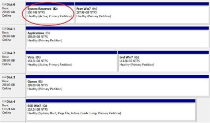

Based on popularity, I did run the repair disk created yesterday...:)
After the first time booting in to the repair disk, the automated process did ask to reboot. Booting into the repair disk at the second time has taken substantially longer, but it did get there; I guess during this time the boot records were created. Once the repair disk came on, it stated that the repair had been completed and Windows is ready to boot from the drive. It did and tested it couple of times without any issues; thanks guys :thumbsup:!!
You know, I've been using Windows 7 for couple of years now, including the evaluation version, but I've never used the snipping tool; nice one...
The Disk Manager has 11 or 12 disks showing up, main reason is that I've replaced the floppy drive with a memory card reader. That added four or five drives, two CD/DVD burners, and plus now there's five physical disks in this desktop. When I put in couple of USB devices, it can get really messy with the drive letters. Here's an image of the relevant disks and please note, I renamed them to keep track of the drives:
Drive K is new and it is the previous boot/system partition. I can browse it, add, delete, etc, within that partition. I could just delete the partition and extend the H drive, but there's no use. I am planning to remove both of the a create a single partition anyway. And before I forget....
Drive K, marked as "System Reserved" in the image, has used 31.8 MBs of disk space. I am not certain as to what actually happened, but the disk image creation does work now. Despite the fact that I do not see "System Reserved" partition being part disk 4. The boot loader must be somewhere since I can boot this drive without an issue.
Looking at the drive in CMD window with the "dir /ah" command shows the folder named "Boot" and a file named "bootmgr", among others of course. It seems that the recovery disk just dumped everything in the C drive, certainly at strategical places. As long as it works and recoverable via the disk image, no argument from me, that would be just dandy.

I guess the only question that remains is the system reserved drive....
Is it "normal" under Windows 7 that there's no system reserved drive and the boot manager resides within the "C" drive?

I'm trying to recap on your thread again. There was another similar one.
To answer your question. It is ok that the SSD has the 100MB system reserved, active function incorporated into the one OS partition (your SSD, C: ). Some people much prefer it that way.
We got to the stage that C: was booting by itself and not through your now disk 0. Ideally your C: should be disk 0. Try
1) swapping cables on Disk0 & 4 and make sure everything boots ok.
2) What do you want to use K:, H: for?
As long as the backed up image can be restored, I am fine with that. Having the boot records incorporated into the C drive does eliminate SVS related errors, which is a plus.
Well, that's not up to me; that's how the BIOS sees them and hands it over to the OS. Disks 0 through 3 are on the SATA 2.0 bus while disk 4 is on the SATA 3.0 bus. I could select any of the disks to boot in the BIOS; the current disk 0 used to be disk 2 until I've replaced the motherboard and messed up the cabling. In either case, I cannot make disk 4 to look as disk 0 for the OS.
K&H will be deleted and create a single partition used for storage. Alternatively, I might get a SATA 2.0 PCIe RAID card and collect all four mechanical drive hard drives in to a RAID 0. The transfer rate of this RAID would be pretty close to the SSD drive's performance.
