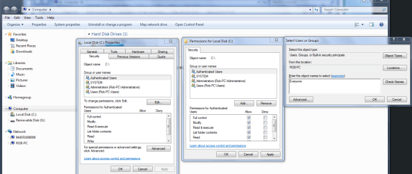

I might also add that once you change the drive over from another machine you will need to use the Security tab, if you want everyone to have access to the drive you will need to add "Everyone" where the picture below shows it.
