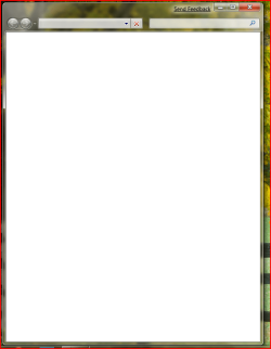

Hey guys.
Lately, when I open up any folder, I get a blank pane (picture included.)
Do you have any ideas how to fix this?
Thanks,
Justin

Hmm, I tried the sfc /scannow, and it said nothing was wrong.. something obviously is.
Also, I cannot boot down properly, I have to hard turn off.
I'm not sure what happened, but I don't have any restore points past yesterday.
Looks like I need to just reformat and reinstall.
Oh, do you know if I run the Windows 7 iso at boot, like I would be reinstalling, if there is a "repair" menu? Maybe I could repair whatever is wrong.

Yeah, have the same problem, it can be fixed, if you enter a path, but you can't move anywhere. Only killing the process and restarting the explorer seems to fix the problem for some time.

Same experience here
It is some bug. It happens on both my desktop and laptop, and yeah, it seems to be related to usb drives. Though I just now got the same behavior after trying to access another partition on the laptop, so I will add trying to access any other "volume". The explorer window will open, and the green "progress" bar will slowly make its way across the breadcrumb/directory field. Subsequent windows will open as blank after that. Killing explorer doesn't seems to work, as it never really "dies". Reboot fixes it. Not an install issue, and I'm 90% sure that reinstalling would just lead to the same thing.

Try re registering vbscript.dll, jscript.dll, mshtml.dll
Run elevated command prompt
type
regsvr32 vbscript.dll press Enter
regsvr32 jscript.dll press Enter
regsvr32 mshtml.dll press Enter
Sorry, disregard the mshtml.dll, it won't work from IE7 and up.

Problem continues
Problem still exists. Re-registering dlls does nothing.
Browsing USB drives, network drives, and even local partitions/volumes seems to cause it to kick in. And it continues on my laptop and 2 desktops I have running Win 7. Wonder what this is about...
I'm grabbing the latest 7 build/leak to see what happens with an upgrade.
Anyone else getting anywhere with this issue? Clues? Guesses?
Windows 7 Beta
I'm having the very same issue with a Gigabyte Technology Co., Ltd. P35-DS3R mobo, 2.40 gigahertz Intel Core 2 Duo and NVIDIA GeForce 8800 GTS (running the newest Win7 beta drivers).
Just a thought: I have Virtual Clone Drive installed...does anyone else with this problem have this program (or another like it) installed?
Windows 7 Beta
As a matter of fact, I do have Virtual Clone Drive installed! I wonder if that could be the culprit...
I just uninstalled it on my laptop. It stalled during removal and I ended up booting into safe mode to get rid of it, though I don't know if that was necessary. A plain reboot might have done just as well. I'll update, but I've got a feeling that the virtual drive has something to do with the problem. Virtual Clone Drive itself has worked fine, mounting iso files etc, but maybe this other behavior is related.

Virtual Clone Drive and Blank Windows?
I've uninstalled Virtual Clone Drive as well. Like quidpro, the uninstaller locked up halfway through the uninstall and the computer rebooted on its own. After the reboot, the uninstall was able to complete. Now I'll see if that makes any difference with the blank window problem.
