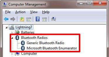

Hi
is there anything at the top of device manager??

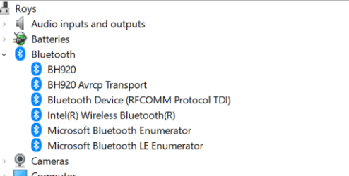

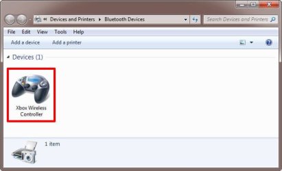

This is what I see in the Device Manager. I can access Bluetooth from the system tray. If I click on it, it shows already paired devices and allows me to add new ones.

Yes, I used to see something similar to what you two are showing. But, as I said, it just doesn't work anymore. Something is clearly broken. I just don't know what and how to fix it.
The picture I showed is from the device manager in with the "View > Devices by connection" option.
In the normal "Devices by type" mode, as you showed, I have the same "Generic Bluetooth Radio" with an USB plug icon but under the group "Universal Serial Bus Devices" group.
The point is: The device is somehow detected and somehow recognized as bluetooth, but that's where it all stops, and won't go any further. I don't get any bluetooth services like you show in your screenshots and which is also what I used to see.
Something went wrong at some point and it has stayed broken.
I tried a couple of linux distros in live mode, and they did detect the adapter and I could connect stuff through it, but not anymore under my W7 install.
I guess it's an unusual problem, but that's how things are.
