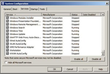

Thanks for this, ThrashZone. I'll be happy to upload screenshots of MSConfig, but there are about 60-80 items there, so a lot of shots. Or is there some way to re-size that window?
Meanwhile, I tried a couple of times to reboot in safe mode, with all non-MS services off except Norton 360, and no applications enabled. No improvement. (Normal startups are only Windows, Thunderbird, Firefox and Cobian plus ShellFolderFix and Classic Shell.)

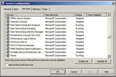

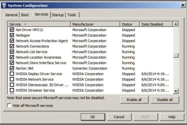

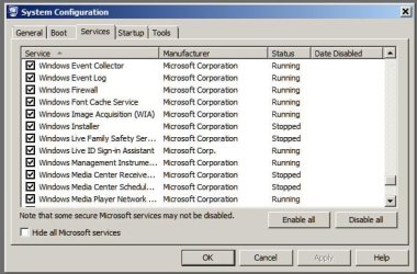

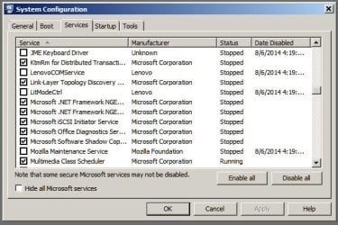

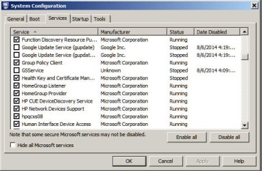

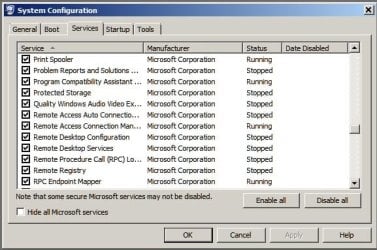

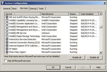

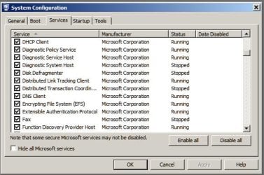

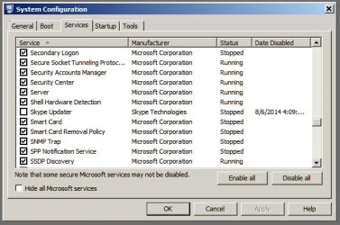

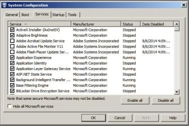

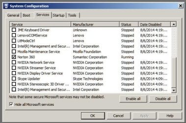

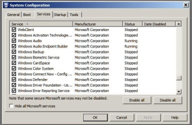

Here are all the MSConfig screenshots. Only item that shows checked with MS services hidden is Norton 360. I'll gather screenshots for IE, if useful - but where the same thing happens in three browsers and Thunderbird, could that help diagnose the problem? Since it seems to happen just when an Explorer-type window opens to indicate where to save files, I'm wondering if it's a clash inside the file-management system. Not that I have any idea what I'm talking about here!
Thanks for taking the time.

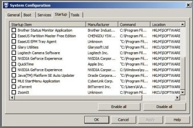

You were supposed to Check the box to Hide all Microsoft services ;)
That would produce a much shorter list,
Replace those screen shots and add-on your Browser add-ons and you also left out the Startup section :(
Cheers.

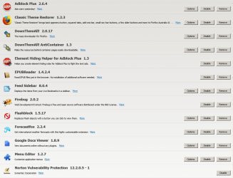

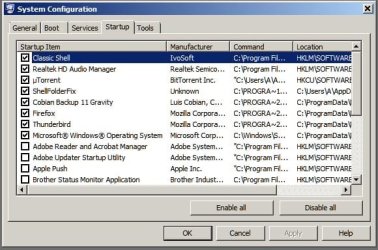

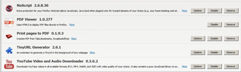

Apologies for my misunderstanding. I hope these are as required.

Hi and thanks,
Firstly open Chrome,
Alter one of the Advanced setting to Not run background apps when Chrome is closed,
Compare your add-ons in each Firefox and Internet explorer,
Post any listing if they exist toolbars and extensions,
Reset Firefox, ...
