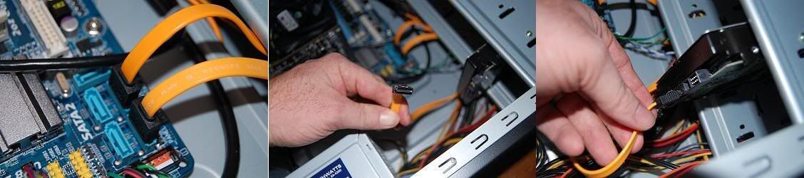

All of your BSODs are pointing to some sort of problem with your hard drive or controller.
Make sure your cables are all secure. Switch to a different Sata connection and see if that helps.
If problems still persist (actually either way do this) run Hard drive tests

I tried replacing an ATA cable with a SATA cable and changed the port on the motherboard. I ran a seagate Long Generic test and the program said that my computer passed.

I tried removing the serial ATA cable connecting the hard drive and disk drive to the motherboard. I replaced the one connecting the hard drive with a SATA cable and I couldn't find my other SATA cable so I just left the disk drive unhooked. I was trying to run the disk check that you asked me to but before I could spend more than one or two minutes on the computer all my icons would disappear on my desk top and be replaced with this.

I just went out and bought a new sata cable for my disk drive to connect it to my mother board and now everything seems to be running alright but I will have to wait and see. I still have yet to do the data check.
