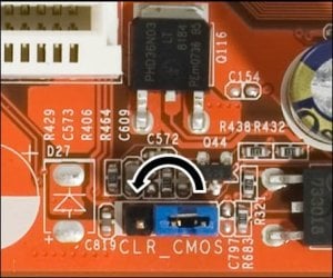

With the computer turned OFF, & the AC power cord disconnected from either the computer or the wall outlet, Pop out the round battery that is about the size of a quarter. Use something non-metalic, like a finger nail or plastic picnic knife. Press & hold down the computer OFF/ON button for 10 to 15 seconds. Wait a good 30 minutes plus, then put battery back in & connect AC power cord. Try starting up & see if you can go into the Bioas immediately and tell us what you find.
There may also be a small jumper on the MB that is labeled CMOS, see if you can find it & take a pic ;)

Cant get the manual on my phone. I said it was an HP earlier. And I cant find any CMOS jumper or serial number to know what anyone is talking about.
