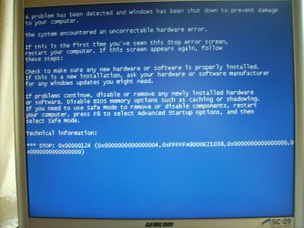

hey guys!
i just downloaded windows 7 rc x64.
at first i wanted to upgrade from 7000, but after the first reboot i saw blue... (BSOD) :huh:
then i thought, it would be better to do a clean install, burned the ISO on DVD and again saw BSOD even before installation progress has started (after Windows had collected information and first boot)... :sarc:
now to my question:
is the BSOD caused by a bad ISO, or is anything wrong with my system?
by the way: Beta 1 Build 7000 x64 works fine...
thanks for your answers! :D
Julson
EDIT: bluescreen-code was 0x00000124
- also see attachment

thanks for your answer, but the same problem also appeared with mounted iso (extracted and not yet burned...). :(
as i said at first i tried to upgrade, but interestingly it was exactly the same error... both after the first boot between bootscreen and logon (or better say continue of install). :huh:
bluescreen-code was:
0x00000124
also see attachment...

Maybe the BSOD itself helps us further: What does all the following numbers actually mean? :sarc:
0x00000124 (0x0000000000000004, 0xFFFFFA8000E21038, 0x0000000000000000, 0x0000000000000000)
(there was another person here who had a similar problem. he updated the BIOS and all worked fine... I have just updated my BIOS and nothing works fine... still exact the same problem.) :cry:
hope, we'll find the solution of the prob...

I Tried several burns and now am installing from a USB Stick.
I was having the same BSOD with uncorrectable hardware error after loading installation files, it would show the starting windows screen....then BSOD 15 seconds later. I noticed it would restart right after my optical mouse would flash I figured it was loading device drivers.
I pulled the PCIx video card and installed using integrated graphics and IT WORKED! Installed fine booted right up. So I shut it down and reinstalled the graphics card and it immediatly blue screened again in the same spot. I started in Safe Mode and it would blue screen right after trying to load a driver file, I can't remember the name of it because I had to reinstall an operating system that would work....it started with pnp*** and it had a .sys extension IIRC.
I've tried disabling C1E Enhanced Halt State, and I've spent the last 6 hours messing around in the BIOS seeing if any other options would allow me to install or run it with the video card.
I'm curious if anybody else who has had this problem has an NVIDIA card or even what type their using....AGP, PCIx, PCI....if this is just in my case or maybe it's the problem that's causing the BSOD for everyone?? :huh:
I've googled myself to death with this problem, I used the first beta release no problem, this has only come up since trying to install RC1...

Interesting, does "hotplugging" mean installing the card while the system is running or to install the card without drivers and then boot and install afterwards. Also I've run Vista for quite some time and never had an issue, what are the chances of this hotfix working with 7? I assume slim to none. :)
I've found something that has to do with the STOP error in the BSOD that the code refers to a PCI Express error so maybe something will come of that, rather frustrating though that this problem is still in 7 if thats the case considering its in RC release now and it's still not fixed...grrr

I am having the same problem, Windows 7 64Bit. I have worked through the beta program and have had less problems than most I read on these pages. The RC has produced this shutdown error. In my case, it happens when I have left the computer idling for, say, more than an hour. I have tried playing with the sleep and hibernate options, without any change.
Adding to this:
For once, I have had a positive exchnage with Microsoft feedback on this. They are putting me through the hoop with a couple of experiments, with subsequent uploading of my dump files. If they come up with a solution, I will repost.
