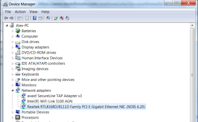

I have been unable to connect to any wifi for some weeks. My machine is a Dell Inspiron 15 1570 laptop.
The router and wifi works fine for other devices.
I have used the MS Windows 7 support forum (and others) which recommends the Windows network troubleshooter and then a series of steps after this. None have worked (although have not updated any network adapter driver).
Nwk Adapter is:
Realtek RTL8168
Device Manager reports the network adapter is working ok, although I have not been able to prove this another way. (Device Manager screenshot attached).

Both of the reports, show that IPV4 is NOT turned on
BT doesnt use IPV6 so you need IPV4
note installed drivers is showing an Avast driver not AVG, you can uninstall it
