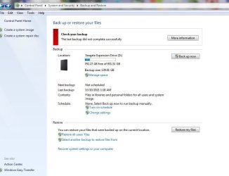

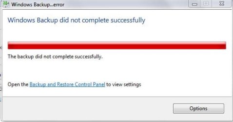

I tried to create a System Image of my Computer onto a new / unused External Hard Drive by selecting Create a System Image from the Back Up and Restore section of the Windows Control Panel but that failed after about 15 minutes - that happened twice - Screenshot attached of error message.
I then tried creating a Full Back Up which seemed to be working but failed after about 9 hours - Error message and other details Screenshots attached.

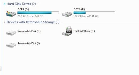

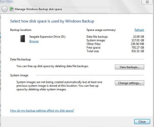

I am also attaching Screenshots of the details of what was Backed Up / put onto the External Hard Drive and also the sizes of used space on my Computer`s Hard Drives.
The Back Up details seem to show that a large portion of the Data that is on my Computer has been backed up although I am sure that the Full Back Up failing means that it would not be useful as a Back Up to use for recovering my Computer as I think that even just a single file missing can cause a Computer to seriously malfunction ?
Please excuse my lack of knowledge / Computing terminology when I describe details such as these.

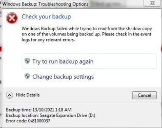

The Screenshot with details on why the Full Back Up failed [mentioning a Shadow Copy] states look at the Event Log for details of what caused the problem.

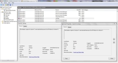

I did manage to open the Event Log but the details about events on the 12th October from approx. 16:09 hours to 13th of October approx. 01:18 hours [when the Full Back Up was running] mean absolutely nothing to me and I do not know how to create a File that could be uploaded to the Forum for Members to view - the events from that time period are a very small portion of what seems to be a VERY large File amount of events wise.
EDIT: I did find an event details in the Event Log which seem to be related time wise and because a Shadow copies are mentioned related to the Full Back Up failing [after over 9 hours] the event details were worded as follows:
Quote: The Shadow Copies of volume C: were aborted because of an IO failure on volume C:
I have attached a Screenshot of the details below.
I don`t know whether that suggests anything specific can be done to resolve the problem with the Full Back Up failing ?

  • WINDOWS BACK UP FAILED - SCREENSHOT - DETAILS STATED RE. SHADOW COPY READ PROBLEM .JPG

  • WINDOWS EVENT LOG VIEWER - EVENT ON 13 OCTOBER AT 01-17-22 - SCREENSHOT OF PART OF EVENT LOG AND.JPG

A system image would be needed to restore the operating system.
The "backup" is for files.
According to your screenshot, your expansion drive "D:" already contains at least one system image , taking up 117gb of space.

The details on the Screenshot about the space used on my new / previously unused External Hard Drive are from the attempted Full Back Up that I tried to create on Tuesday 12th October - the System Image details are from that attempt - I obviously don`t know whether that IS a full System Image because the Full Back Up failed after about 9 hours.

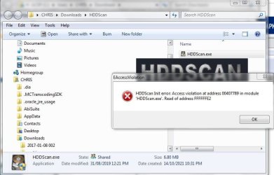

When I tried using the SeaTools software there were no results displayed - the Forum Member who suggested scanning my Computer with it wrote that there would be results after the scan but it did not produce any - I tried another type of scan which kept failing at 10% - again there were no result details.
I have not seen a Repair facility on the SeaTools onscreen display but I will look again - I might have to ask more about that because I don`t want to just launch any program / Fix that might cause more problems for me.

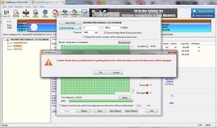

Are You stating that because the SeaTools Hard Drive scanning program did not seem to work on my Computer - one scan just showing a `Fail` of something during the scan and a `Short Test` scan failing at 10% that my Computer`s INTERNAL Hard Drive needs to be replaced ?
When I was being helped on that previous thread - a Blue Screen of Death shutdown problem Dump Files etc. related to a shutdown were analysed by one of the Forum BSOD Expert Members - He did not find a Hard Drive problem.
I also recently ran CheckDisk and SFC /scannow - the SFC /scannow produced CBS.Log files which only showed a few corrupted files which were not automatically repairable - a Forum Member informed me that they were related to a Bluetooth program although I have never connected a Bluetooth device to my Computer.

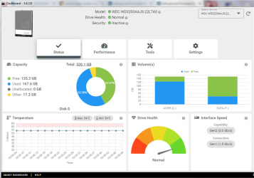

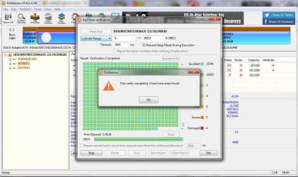

Hello again SIW2,
Thank You very much for the link to the Western Digital Hard Drive scanner I downloaded and ran it.
I have attached a Screenshot of the Status results display - does this confirm that the Hard Drive does not need to be replaced ?
When I was previously trying to find out by online searches why the SeaTools Hard Drive scanner did not seem to be working correctly on my Computer I read quite a few comments that stated it did not work on Western Digital Hard Drives - perhaps that is the case on my Computer ?
Thanks again for your help.
Chris
P.S: When You asked about the System Protection properties if that was to check whether a System Image had been created [?] I think that I should have had the External Hard Drive connected to my Computer ?
If that was what You wanted to check please let me know and I will connect the External Hard Drive and look at the details in System Protection again.
Sorry if I should have realised this previously.
Chris

That looks ok so far. Can you get it to run a test so you are certain all is well ? Cant remember where it is - under the tools tab probably.
If you get the all clear from test, then your problems are software related. In that case I would just bite the bullet and do a clean reinstall to get rid of all the issues - easy for me to say as I have done it hundreds of times. Back up the activation first with dism++
Hello SIW2,
I ran the SMART Short Diagnostic Test and the SMART Extended Diagnostic Test - they both gave the result:
Quote: One or more errors - Error Code 7
However I cannot find any where on the Dashboard where Error Code 7 is explained - I will do a Google search for that tomorrow afternoon as I am now being called for Dinner and have an appointment tomorrow morning.

No. was just checking there is enough shadow storage on C which is where the io error is coming from.
The smart test error might be a concern.
WD hdd failed in smart-test with status code = 07 | Tom's Hardware Forum

Hello SIW2,
Thanks for finding that referrence to the Western Digital Dashboard Error Code 7
I looked at one of the recommended Hard Drive Disk Scanner downloads but it was for a 64 bit system.
After searching to try and ensure that it was a Safe / recommended by other Computing websites program I downloaded the other recommendation which was the HDDScan Hard Drive Disk Scanner - unfortunately after extracting the Zip File to get the HDDScan.exe file and clicking on it to Run as Administrator I immediately received the Error message in the Screenshot attached.
I definitely followed the instructions related to the Scanner download - extract from the Zip file and then Run.
The download was from the Softpedia website which I believe from past experience and online research is a Trusted / Safe website from where to obtain Safe / Tested downloads.
I will look online again tomorrow afternoon for further information on the Western Digital Dashboard Error Code 7.
Could I ask You a favour - please don`t be offended:
Just in case this Hard Drive Disk error is something not directly related to my Computer`s Full Back Up failure problem would it be possible to go back to my first message on this thread to try and look further into the first error message about the Shadow Copy as it directly identified that being involved in the problem of the Full Back Up [including a System Image] not being completed.
I would really appreciate help in trying to either confirm or discount a Shadow Copy problem - whatever that is ?
Thanks again for your interest and for trying to help me with this.
Chris
P.S: The HDDScan.exe Error message Screenshot is attached below my next message which was automatically added to my reply to You SIW2.

As the first Error message that I received after the Full Back Up of my Computer failed mentioned a problem with a Shadow Copy - Screenshot attached - I wondered if these steps listed below are relevant to my problem - I found them on another thread within the Forum Back Up and Restore section:
To check / fix the Volume Shadow Copy service:
1. Click Start/Run: services.msc
2. Find: "Volume Shadow Copy"
3. Right-click, and adjust properties, set it to Automatic (Delayed start).
4. While still in that window start the service manually
5. Run backup again.
I know that Members might state `Just try it` but I want to be carrying out unnecessary alterations in case I cause more problems than I already have.
Here is the other thread where the suggestion above was found by me Today:
Backing up system image, error 0x81000037
Thanks for looking at this.
Chris
  • WINDOWS - ACER HARD DRIVE SCAN - HDDScan - ERROR MESSAGE IMMEDIATELY ON TRYING TO RUN IT - SCREE.JPG

Much as you dont want it to be a problem with the hd, it is looking like that is the issue.
Both the the seagate and the wd hd tools have told you there is a problem, and that is consistent with the i/o error

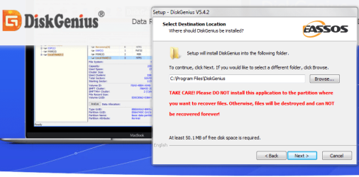

Hello again SIW2,
I downloaded the DiskGenius software but as I was about to click to Install it I received an onscreen display with a Red text Warning message - Screenshot attached.
I obviously have not installed DiskGenius until I asked You / other Members about this Warning message.
I am having some really `Bad Luck` tonight with these Hard Drive Disk Scanning programs.
Chris

If using a program for file recovery or data recovery it is not a good idea to install it to the partition you want to recover data from.
You are not doing data recovery. That message is not relevant

Hello SIW2,
Thank You very much for explaining that to me.

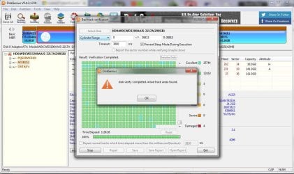

I have now ran the DiskGenius Disk Verify facility for both the C Drive and the F Drive on my Computer and I was hoping to be able to attach not only Screenshots but also the Results Logs to this message.
However although I did save the Disk verification results logs I now cannot find them on my Computer - I had thought that the File titles would either start with DiskGenius or DG or dg but I cannot find anything in lists of files starting with D of d - I will look again to see if I can find and upload the results files to the Forum.
I watched the Disk Verification process for both of the Drives where thousands of Hard Drive `Cylinders` were scanned - the results were that there were `4 bad track areas` found on each Drive.
Unfortunately I could not use the `Repair` facility because a Red text Warning was displayed which stated users should NOT use the Repair facility without Backing Up because there could be further problems after the Repair process was carried out.
I am attaching Screenshots of the result of the Disk verification process for my Computer`s C Drive and the Red text Warning message when I tried to use the `Repair` facility to rectify the 4 bad track areas.
Exactly the same situation occurred for my Computer`s F Drive after the Disk verification process - the same Red text Warning message about using the Repair facility was displayed.
As my problem is NOT being able to carry out a Full Back Up / System Image that rules out using the DiskGenius Disk Repair facility - I cannot risk further damaging my Computer.
My Life cannot run without a Computer because I am Housebound due to a Life changing severe Back problem and Knee problems so I need Internet access to do online Food / Grocery shopping and Banking / Bill payment etc.
Thanks again for your interest and for trying to help me.
Chris
  • WINDOWS - ACER COMPUTER HARD DRIVE C DISKGENIUS VERIFY SCAN - SCREENSHOT SHOWS 4 BAD TRACK AREAS.JPG
  • WINDOWS - ACER COMPUTER HARD DRIVE C DISKGENIUS AFTER VERIFY SCAN - SCREENSHOT OF WARNING MESSAG.JPG

That is not a good sign.
It is going to cause you grief.
One thing you might try is a used disk from cex. They are very cheap, and come with a guarantee. Of course they are used so you never know how many years are left in them.
500gb mechanical disk for £5. I think it is an extra £1.95 if you want it posted.
There is probably a branch in your area, perhaps somebody could pick one up for you as an alternative to posting.

Once you have transferred everything to a new disk, you can try repairing the old one. The problem with that is the disk controller is supposed to do that automatically. Obviously, it isnt - so even if a repair can be effected, I wouldnt rely on it.
