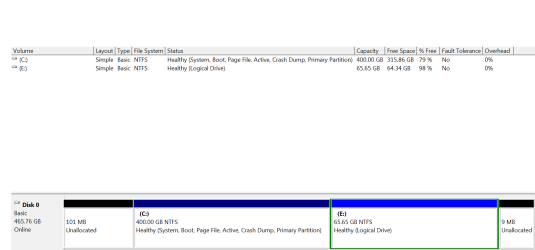

As requested I have attached a snip of disk management.

You said that during a booted XP installation you deleted the XP partition, created and full formatted a new one, correct? If so I wonder why it's made a Logical partition. It should be Primary. Try it again.
While XP will install on a Primary partition, Win7 cannot place its boot files there to configure the Dual Boot. So try XP install to a Primary partition which is what should be created if in fact you delete the partition during install, create and full format another.
Yeah, I booted the xp disk and when it loaded i highlighted the xp partition and pressed "d" to delete, then "L" to confirm deletion of the partition. I then formatted the unpartitioned space fully (ie not quickly)
The above snip is the result of doing that.

Well in that case delete the partition in Disk Mgmt, then delete the resulting Free Space using Delete Volume, which should allow you to create a new Primary partition there.
If you need to force it then install free Partition Wizard bootable CD to specify creating a New Primary partition.
Are you even aware that when you reinstalled Win7 to C you abandoned it's 100mb System Reserved boot partition? One thing that could be tried is recreating and reactivating that boot partition which sometimes works with these types of anomalies.
