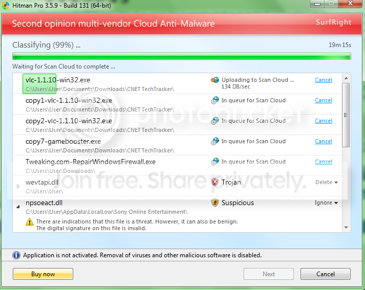

EDIT: Malwarebytes cleaned up a bit again, but what am I supposed to do with Hitman Pro? It's scanning, but I notice on the bottom that it says that it's not activated, so it can't remove anything. Does this mean I need to buy it? If so, I can't right now. It's also kind of stuckat 99%. Here's a picture:
Edit 2: After half an hour this screen changed. Disregard. Currently I have Comodo Firewall installed. It's really nice. I might keep it, but I'd still prefer to have solved the Windows Firewall issue.
Hitman Pro lets you activate it for free after it finds something. You will have 30 days to scan/delete/repair, and after that you will have to buy it.
