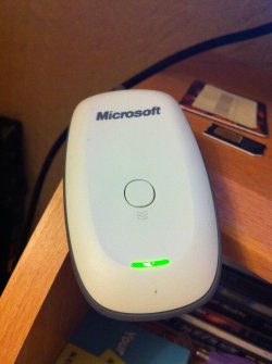

unfortunately you have purchased a knock off to the real thing, the real device looks like this:
and as you can see, it says Microsoft instead of Xbox 360, i'd seek a refund immediately.

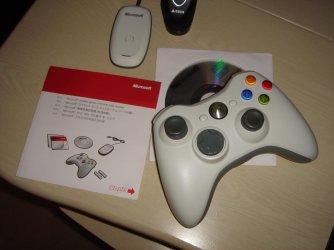

i got the original one that comes in a package with Booklet + Installation Manual + Driver CD and never had any trouble syncing the controller or disconnection during anything and it does say Microsoft just like MrNeeds mentioned above. Here's the pic below and sorry for dull result :p
