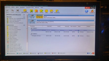

Why is the Seagate backup drive plugged in? All other disks are to be unplugged during repairs as stated in the tutorial.
I don't know how both System Reserved and C can be Active. Only one partition per drive should be allowed to be Active at a time. So rightclick C to Modify>Set Inactive, click OK, Apply step.
Then highlight Disk 1 label, from Disk tab select Rebuild MBR, OK, Apply.
Then boot into Win7 disk to run Startup Repair - Run 3 Separate Times .
If that fails test the hard drive with the maker's HD Diagnostic extended CD scan, or if there isn't one use the PW Surface scan from the Disk tab. There could be serious disk problems if it allows two Active partitions.
Next I'd do the Bootrec commands from tutorial again to export and RebuildBCD.
If that fails delete and recreate the 100mb System Reserved partition from Step 10 in Troubleshooting Windows 7 Failure to Start

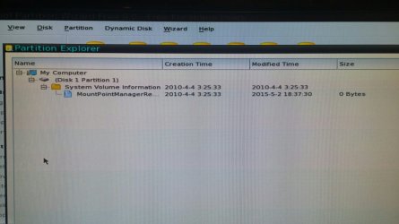

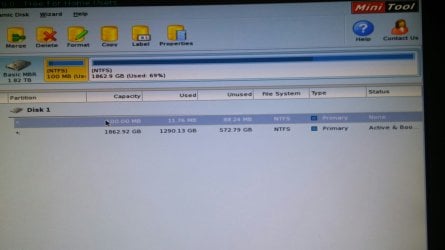

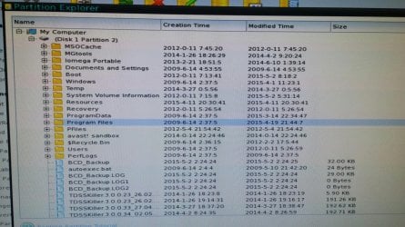

If you see the images I provided, the MiniTool doesn't even label my drives or the partitions by letters. It shows Disk 1 and the partitions aren't named. The MiniTool provides the option to label partitions and choose drive letters but they don't allow you to actually type anything or actually make a choice. Maybe unique to my machine. In my system, within Windows, the System Reserve is C.

Now what? Is there a way to copy the boot files you uploaded via the MiniTool?
Windows 7 Home PremiumIntel Core TM 2 Quad CUP Q6600 @ 2.40 GHz
P5KC
Dual
Chrome, Safari, IE
I'm not referring to labeling anything. The small 100mb partition shown here is obviously the System Reserved partition. I only said that if you performed Step 10 to delete it and then recreate it as a Primary partition marked Active, that it does not show in the Status column on the right that the partition is marked Active. In fact if you look in Status column you will see that the large Win7 partition is the Active partition. Did you miss the step to mark the recreated System Reserved partition Active? That's all I asked.
361191d1433262984-cant-reboot-repair-restore-aft-aborted-avast-uninstall-oxc-000000f-1-screen.jpg
Errors at boot such as the NTLDR XP boot error do not stop a disk from booting and only mean that the boot media has been bypassed and the hard drive is already trying to boot. You'll need to find out why your media is not booting. Are you using the one-time BIOS Boot menu key at boot? When you select the DVD drive does it prompt to "Press any key to boot disk?" If not the disk is not being read. Will another bootable disk still boot in the PC?
The installer should write the Boot files to the Active partition during 3 Startup Repairs but if not you can extract the boot files to a flash stick, plug it in, then from the booted Win7 disk browse to the stick to copy the files to the Active partition following Copy & Paste - in Windows Recovery Console. I do not see the boot files on the System Reserved partition now, however if you recreated it and did not mark it Active all the installer will do during repairs is write them again to the Win7 partition which is marked Active.
Thanks. I either didn't hit apply to make it a primary/active partition or I took that snapshot after the last part of step 9 where you try the Windows partition if the system reserved partition didn't work. In any case, I tried step 10 again to no avail. I was able to boot into the Win 7 DVD although it wasn't working earlier. Then I uploaded the boot files you provided and did three repairs again. Most of the time Windows Repair couldn't find the problem after the first restart.
Now, when I boot up without the Win7 DVD, I get the NTLDR is missing error.
I've put a MiniMint setup on a flash drive and have started backing up my files. Given that I've probably got 40 programs or more on this PC and 600GB of software and data, I was hoping to avoid a destructive install of Win 7 but it looks like I'm running out of options.
Any other suggestions?

If you completed all the steps fully then I don't know of anything else to do except that you could shrink C using Partition Wizard Resize Partition - Video Help. Then install a new Win7 to that space you shrunk, which should configure the old OS into a Dual Boot.
If not you have the new install to set up; we'll help you remove the old Win7.
If so then you can boot into the old OS and delete the new one in Disk Mgmt since the System boot files will be refreshed on the System REserved partition if it is still Active.
As long as you don't touch the old partition during then the files should be intact after install as there's no way for the new install to affect another OS partition.
