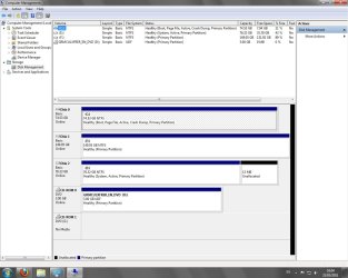

hello all!
i encountered a problem after installing a new hard drive
i have 3 HDs (including the one i just installed) C: wich is where windows is installed and E: and F: for data
after installing the new HD ( F: )and formatting it, my system stopped booting, it just hangs, so i changed the boot order and it boots fine, but not through C: but through E:
i also found new BOOT folder in E:, wich wasnt there before
i believe that the HD the system boots from should be the one Windows is installed on ( C: ) so if im not mistaken (very likely i am) i should have C: marked as BOOT and SYSTEM in the Disk Management window
i searched a bit but cannot find a way to fix this, help would be greatly apreciated!
this is a screenshot of my Disk Management window
Welcome to the forum, I don't know enough to help but I did notice from your screenshot that you have 2 Active partitions so perhaps that is the problem. Wait until one of the experts comes along to help I just wanted to welcome you and point out my observation.:)

thank you for the warm welcome, its helpful in a way to :)
also, i should have mentioned that initially just E: drive was active
both of them being active is a result of my attempts to fix this
didnt think it can have an effect but ill try having only C: active and report back

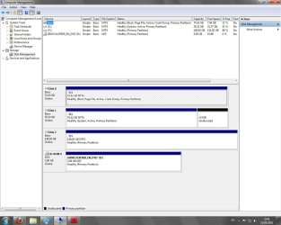

Can we see another screenshot of Disk Mgmt with all HD's plugged in?

and here's another screenshot, nothing different except different order of HD's
