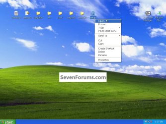

1) Right click Setup and click Open to start the installation process.

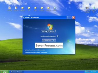

2) In the window that opens click Install Now. If need be, you can Check Compatibility here now to make sure there will be no issues that need addressed before you start the installation process.
3) You'll get Setup is Starting; then this Get Updates dialog box, just select to not get updates during the installation process, it just seems to go smoother this way, Windows will auto-update later, after the installation has completed.

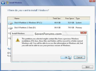

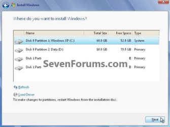

5) Be sure to click to highlight/select the Windows XP C: partition to do the installation to, you don't want to select the wrong partition if there is more than one; then click OK for the Windows.old dialog box.
It will Copy Windows files first, that goes fairly fast.

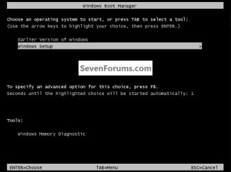

6) Then it'll start Expanding Windows files to about 27% and restart and you'll see this boot screen in the second snip down, it's not a dual boot so don't be concerned, that's normal.

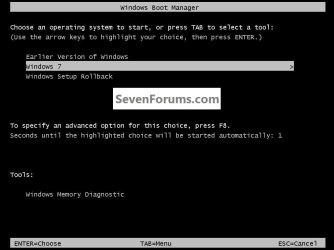

7) Then it'll finish Expanding Windows files and then a second restart, as in this second snip, same thing, don't be concerned that's normal and it will correct it's self by the time the installation completes and it'll boot straight to Windows 7.
8) Then you'll see Updating Registry Settings, than Starting Services, then Completing Installation and a normal restart.
