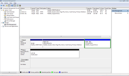

Interesting... Those two tutorials you posted are in fact the ones I used. Here is the screencap.

Then I don't understand how you ended up with a OEM partition before the (C) partition on disk (0).
**Where and how did you get your copy of Windows 7?
You state you have XP installed. I don't see it.
I think what you did was wipe XP on disk (1) and Windows 7 is booting off the (C) partition on disk (0). Which is okay.

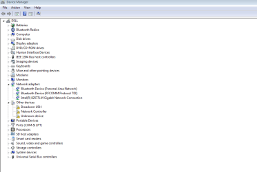

Third one installed successfully, I initially didn't install it because I was concerned installing out of order might cause issues, my bad. As for the second part, I can't locate the wireless card in Device Manager:

Install the following Driver .... Dell ControlPoint Security Device Driver Pack ...
Select the Network Controller right click select Property's / Details Tab ...
Post any info you see there please ...
As for the other Devices the first Driver should fix that ...

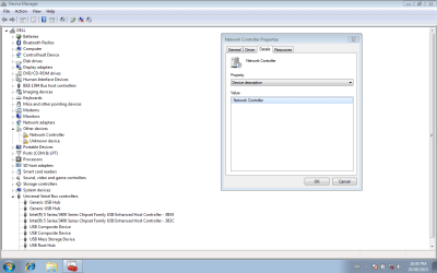

When I open Properties to the Details tab, it is by default on "Device Description", where there is not much of value. Which properties would you like to look at? I can't post them all right now since there are quite a few.

It is the Network Controller we need to get sorted ... Unless you can remember which one was Installed it is any ones guess ...
There is quite a lot of Drivers on the Dell Website for Wireless ...
Apart from Opening the Machine do not know what else to suggest ...

Looks like I got lucky, internet now works after trying 2 drivers. Thanks for the help.
