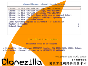

2. Download Clonezilla from the website and burn the iso to a CD. Reboot the computer to the CD. It is a "live" CD in that the program runs off of the CD and does not install anything to the hard drive.
3. Select the screen resolution you wish to use.
4. Select your language.

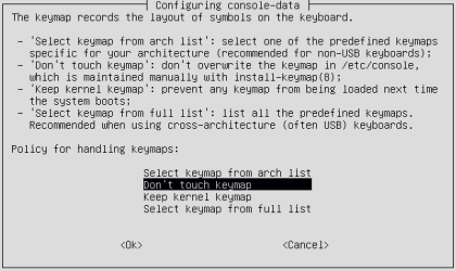

5. Keep or change your keyboard layout.
6. Start Clonezilla

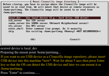

8. Select to use a local device (hard drive) or a network source.
NOTE: After selecting "local_dev" you are given the option of inserting a USB drive.
9. Press Enter to continue

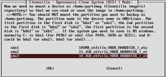

Linux names hard drives "hda#" or in my case "sda1, 2, and 3". The 105MB boot partition is sda1, the Windows partition is sda2. Clonezilla wants to mount the partition where it is going to put the image, in my case sda3, a backup partition I created.
10. Select: sda3

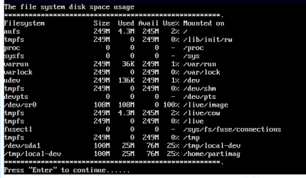

11. Select Top_directory
12. Now you get to see some info, press enter to continue.

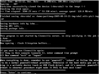

17. You will get a message about using command line. Press ENTER to continue, then type "y" and ENTER.
18. You will see a message when the image is finished, press enter to continue
cloneZ_15.png]
19. Make a selection from the menu and press enter.

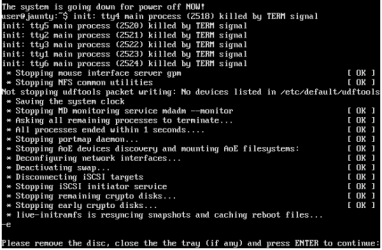

20. The CD tray will open so you can remove the CD, then close the CD tray, press enter, and reboot into Windows.
Clonezilla saved my 12.5GB Windows partition to 6.78GB and the 105MB boot partition to 9.75MB. As Windows grows so will the size of the saved image and the partition to save it in.

I use Clonezilla to clone my drives once a week. If anything happens I have a back up. Just plug and go.
belikexp;
Thanks for the input. Clonezilla is so easy to use, yet few can be bothered with backing up their data.
Just curious: Where do you put your backup file? How do you manage your weekly files?

Update - Nov 2009
As an update to this thread, I have received my retail copy of 7 Home Premium, installed it on my Dell 505 laptop (least used and smallest data size), backed up with both Clonezilla and the 7 backup utility, and restored successfully with both methods. So I have no worries if I ever find myself needing to reinstall my 7 upgrade.
My upgrade (both the download from MS and the retail box) would not activate unless I started the upgrade from my activated 7 RC, as expected. I could even delete the 7 partitions and reinstall fresh as long as I started the upgrade in Windows.
Restoration was flawless, however I am having issues copying/moving the 7 backup and image (not the clonezilla image) to a different location. Not sure what that is about. As soon as I get my external USB hard drive setup, I plan to save the Windows backup externally.
Cheers to all!
