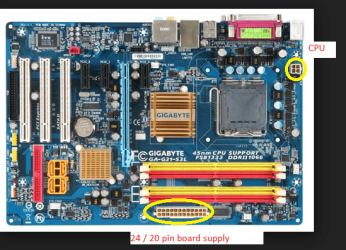

im planning to change my psu if dell's psu cant handle it. a seasonic with two +12V rails
BUT the problem is i found out that my mobo has a 1 slot for +12V rail. and i think the psu will not fit? in the desktop case cause its narrower than minitower

A screen shot of the case would be handy NFS and usually unless it is a low flat case like some Dells and Lenovo's can be PSU's are generally a standard size / fit.
Am not sure what you mean by a one slot for the 12v rail?? The board supply is usually through a 20 or 24 pin plug / socket on the board itself.

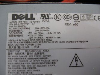

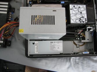

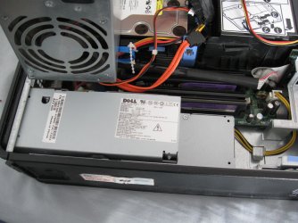

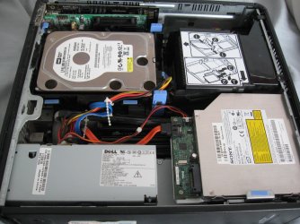

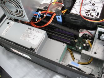

if it's like a old optiplex i have it will not if its not a low profile one. took some pics for reference (sorry for bad angle). you can see my psu is 275w.

dota and lol will stress it somewhat imo since its cpu heavy and counter strike will stress it with gpu, on low settings not to bad though. from your other thread it seems that you might want to just try it since its hard to get a low profile system like that (or you can if you don't care have a standard psu have cables feed into the optiplex through the back, not pretty but works) i am using a g 210 which at load consumes about 21w and a xfi xtreme gamer sound card in that one i posted in your other thread and it is a p D930 also with 4x1GB DDR2 800. my temps are quite hot though and it is just in use a HTPC.
