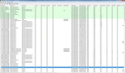

If not, run USBdeview and post what you have there. View any installed/connected USB device on your system
To do this, make sure the USBdeview program is showing all contents on the screen. Go to the start orb and in search begin by typing snipping tool. Open snipping tool and take a screen grab of USBdeview. Post the image here or at imgur. Share the link.

I already have USBdeview installed, so can easily post a screenshot. I'll wait until I am getting the USB disconnect sound though before I do so - it doesn't happen all the time. There are a lot of devices shown.. would you need to see all, or just the ones that are highlighted as being connected?

I have heard the usb sound a couple of times, so post a screenshot of the top of the window.. if you want the whole lot just let me know (it'd be several screenshots). Thanks.
I can't enter the URL of my screenshot using the image icon - don't know why. It is:
http://img.photobucket.com/albums/v68/martinlest/grab_004_1.jpg
grab_004_1.jpghttp:

Can't see anything on the link.
Use the paper clip - browse to the file - upload

OK, try again

Tried to upload files as requested, but I just get "HTTP Error 400. The request is badly formed."

On Grab_005.jpg you have 10 devices that are listed as connected (green). Can you name and explain ALL ten?
- USB gaming mouse. What brand? Is it wireless?
- Nostromo speed pad?
