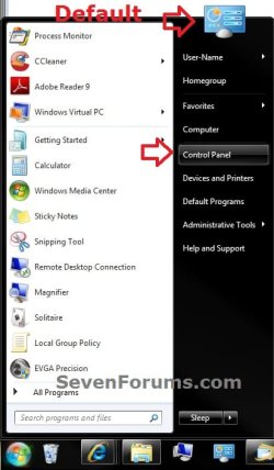

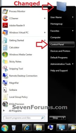

This will show you how to change the default Control Panel icon in the Windows 7 Start Menu, Desktop icon, and navigation pane to be a icon of your choice.
You should use a 256x256 pixel .ico (icon) file to have the best support for all icon view sizes.

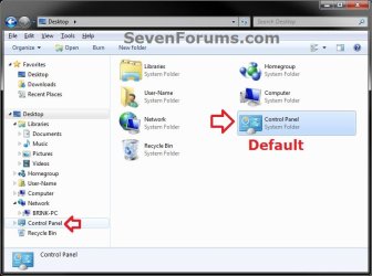

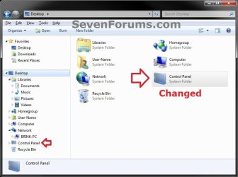

EXAMPLE: Default and Changed Control Panel Icon

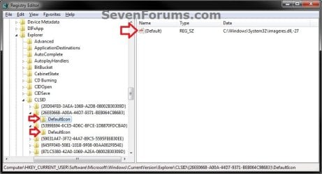

G) In regedit, navigate to the location below. (see screenshot below)
NOTE: This will be the registry locations added from steps A to D.
HKEY_CURRENT_USER\Software\Microsoft\Windows\CurrentVersion\Explorer\CLSID\{26EE0668-A00A-44D7-9371-BEB064C98683}\DefaultIcon
H) In the right pane of DefaultIcon, right click on (Default) and click on Modify. (see screenshot above)

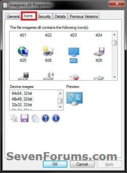

J2) In Windows Explorer navigate to the .exe (ex: for program icons) or .dll (ex: Windows 7 icons) file that contains the icon that you want to use, right click on the file, click on Properties, and the Icons tab. (see screenshot below)
NOTE: The most common Windows 7 icons come from the C:\Windows\System32\imageres.dll file.
J3) Make note of the icon number for the icon that you want to use instead. (see screenshot above)
NOTE: For example, the default Control Panel icon number is 27.
J4) In the Modify window from regedit, type in the full path of the .exe or .dll file followed by ,-icon# (full path,-####) and click on OK. (see screenshot below)
NOTE: For example, if I wanted to use the path (step J2) and the 27 icon (step J3), I would type:
%SystemRoot%\system32\imageres.dll,-27

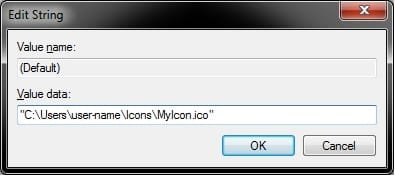

K) To Use a Custom Icon of Your Own
K1) In the Modify window from regedit, type in the full path of where the custom icon (.ico) file is saved at with the file extension in quotes, then click on OK. (see screenshot below)
WARNING: You will need to use a 256x256 pixel icon that was made for Windows 7 and Vista for them to display properly at all of the available icon view sizes in Windows 7. You will also need to leave the icon (.ico file) saved at the exact location you typed below for it to continue to work. If you delete or move this icon, then it will no longer be displayed.

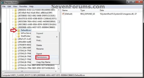

C) In regedit, navigate to the location below. (see screenshot below)
HKEY_CLASSES_ROOT\CLSID\{26EE0668-A00A-44D7-9371-BEB064C98683}\DefaultIcon

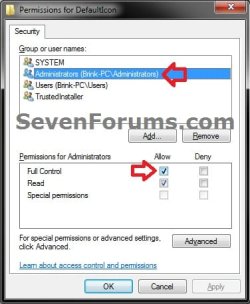

D) In the left pane, right click on DefaultIcon, click on Permissions. (see screenshot above)
E) Select your Administrators account, check the Allow box for Full Control, then click on OK. (see screenshot below)

I) To Use a Custom Icon of Your Own
I1) In the Modify window from regedit, type in the full path of where the custom icon (.ico) file is saved at with the file extension in quotes, then click on OK. (see screenshot below)
WARNING: You will need to use a 256x256 pixel icon that was made for Windows 7 and Vista for them to display properly at all of the available icon view sizes in Windows 7. The icon will need to be saved in a location that all users have access to. For example, in a C:\Users\Public folder. You will also need to leave the icon (.ico file) saved at the exact location you typed below for it to continue to work. If you delete or move this icon, then it will no longer be displayed.
