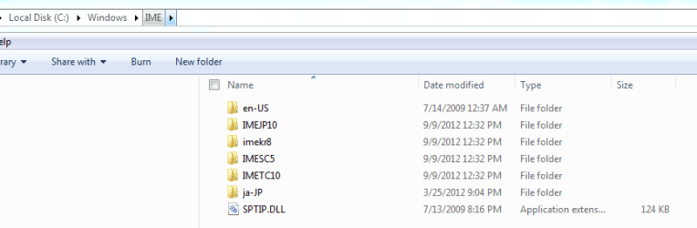

1) Scan Results
2) Snippet of IME directory in C partition - Is there anything here that would indicate a corrupt file that could be manually repaired?

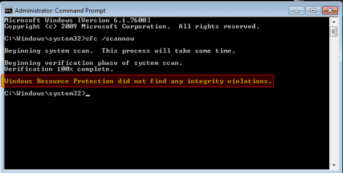

Just ran sfc /scannow in an admin command prompt -- and ......
Amongst the mountains of text found in the log file, a "find" of "language" appears to indicate an attempt to repair this language pack.
That concurs with my original suspicion, that the Japanese language pack is defective.

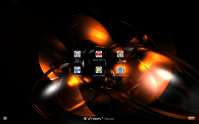

(Click to enlarge)
Depending which language I need, I can login to respective user account. My normal and Admin accounts in English, other accounts in Finnish, Swedish and German.

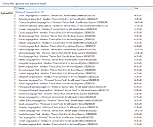

To change a display language you need first to download a language pack in your chosen language, log in to user account you want to change display language and then from Regional and language properties > Keyboards and languages select correct language:

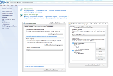

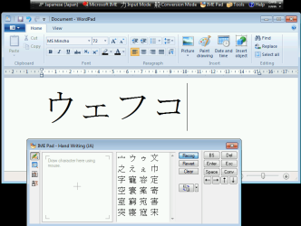

Update: check out the attached screenshot. You can see the Japanese language bar nicely opened at the top.
For some odd reason I can open the IME Pad, with which I can draw Kanji (Chinese Characters) BUT NO OTHER MENUS OPEN!

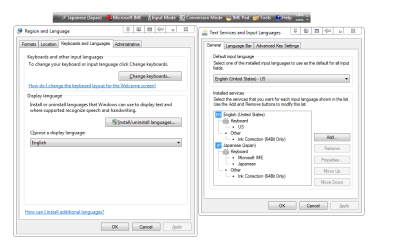

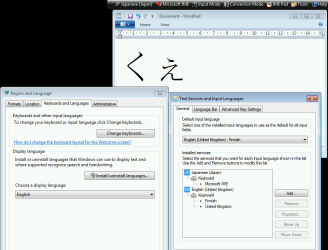

Look here, screenshot from a Windows 7 virtual machine running on this Windows 8 PC I am using now. Japanese (Katakana) typing on Windows WordPad using Japanese IME keyboard layout (Input Language), absolutely no Japanese language packs installed:
It should be already clear for you but to be sure, once again: your screenshot shows the Windows 7 Control Panel option for changing the input language (keyboard layout). It does have nothing to do with language packs.

Conclusion: The language pack I am trying to use is corrupted. (Snippet attached)
Question: How to repair it without a complete reinstall of Win7 Ultimate 64 bit. Note: I am using Office 2010 Pro, not 64 bit which is defective in design. My only add-on is Multi-Tabs free and a few macros I wrote.

I don't want to confuse you with facts, but I have attached two snippets which are the result of following your advice.
Snippet #1 shows that the Japanese IME had been removed - as you suggested
Snippet #2 shows that, after reboot, the Japanese language pack is no longer available.
All you need to do to start trying to fix your issue is what I asked you to do in my previous post: Go to Region and Language properties, click Change Keyboards, disable Japanese IME, reboot, after reboot go back and enable Japanese IME and check if it is working. If not, come back and we will try something else.
The result is now No Language Bar (or whatever you choose to call it), No menus to set the input method (Romaji, hiragana, katakana or kanji via the IME drawing pad) - actually No Nothing now.
Did what the expert said. Did I do something wrong? Check out the results which I believe will speak louder than my words.
I said I will bail out but I will make one more try: READ THE HIGHLIGHTED PART OF MY TIP YOU QUOTED!
Your screenshots show very clearly you did not add / enable Japanese IME after reboot.
You are indeed correct. That is my mistake and I sincerely apologize. Will let you know.
Thanks for being so very helpful - and no, that is not at all sarcasm. I do appreciate your thorough and caring support.
Now, off to do as you said. :o
Win 7-64
Back again.

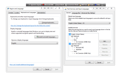

As you can see from the screenshot, I did what you suggested.
Result: Same as before, the language bar can only be opened with the keyboard Alt/Shift (not a huge problem but different from before when a mouse click on the EN icon opened it) -- and clicking on any of the icons only results in a flicker just as if the menu is trying to open but cannot. Same as before, only the IME kanji drawing pad will open. The other icons do not.

OK, I have done some testing, mainly trying to reproduce your issue. No luck there, can't reproduce it. The Japanese input works like a charm, both using keyboard and IME input pad:
Please note that as I have told before in my previous posts, no language packs are needed for this. Both the desktop and one virtual machine I used to test this have an English Windows 7 and no Japanese language pack, although the desktop has Finnish, Swedish and German language packs installed for other user profiles but I tested Japanese input on a user account using English as display language.
My recommendation now is to disable Japanese IME, reboot, run sfsc /scannow as many times as needed(*) to fix all possible errors. After that a reboot, enable Japanese IME, open WordPad and try.
(*) SFC /SCANNOW sometimes needs several passes to fix all issues. If after scan is completed you get a message telling that SFC could not fix all errors, you need to run it again. SFC / SCANNOW needs to be run from elevated command prompt. Tutorial: http://www.sevenforums.com/tutorials/1538-sfc-scannow-command-system-file-checker.html

For what it's worth I uninstalled the Japanese Language update completely (it now shows as an update to choose, which I will not) --- and --- I have uninstalled and reinstalled the Japanese IME many times.

(http://www.sevenforums.com/attachment.php?attachmentid=246190)
This I can do - and have done as well. This IME drawing pad is in fact the only icon that actually opens when clicked upon. The other Input and Output choice just shudder for a nanosecond but never actually open. But the IME pad does actually work.
Win 7-64
No problems.
SFC (System File Checker) itself does not fix errors, it only scans. The magic is done with the /SCANNOW switch. Sometimes it really needs a few passes before it finally says "SFC could not find any errors".
When testing, be sure you have an text input application open and active, word processor or such; if no apps that accept keyboard input is active, the language toolbar wont let you use the menus.
Do the SFC scans and come back to tell what happened. To be sure SFC really has the chance to fix possible errors, reboot after disabling Japanese IME, run SFC scans, again reboot and first then enable Japanese IME again.

Found http://www.sevenforums.com/tutorials/1538-sfc-scannow-command-system-file-checker.html
Didn't realize what a seriously good group this is. I do now. Thanks.
Ran sfc /scannow and the results are scary - lots and lots and lots of unrepaired problems.
Will boot. Run sfc /scannow again - and again until all problems are resolved?

You do not need to reboot between SFC scans. Do it only before the first scan, and after the last one, although no harm done if you reboot even in between the scans.

SFC / SCANNOW will tell you when it can no longer find errors:
