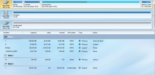

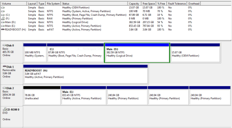

I ran Startup Repair on the Win7 boot disk, prior to looking at it, and when I moved it to the dock, the data partition was there. As you can see below, the 100MB System and OS partitions were merged into 79GB of unallocated space. I guess the DNAB overwrite was halted somewhere while munching the partition table - possibly partially mitigated by Startup Repair? - is that how that could happen?
Here is the DM snip - it's clear something's wrong with the disk administration, it's only a 1TB disk. Thankfully the data partition seemed intact and I backed up all those files from it. The Partition MiniTool snip follows.
The Win Recovery disk recognizes a System Image I saved on that data partition, so if need be it seems I can restore to last December from there. Not the worst outcome for that drive but if I can repair the installation to where it was yesterday, or even a recent System Restore, that would be ideal.
