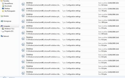

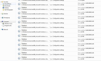

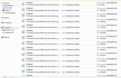

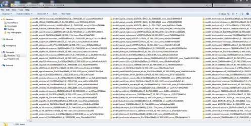

Hi GoKay - I did change the properties in the folders to GENERAL before but I cannot find an actual desktop.ini file - I went into My Computer and searched 'desktop.ini' and it just listed lots of entries but not an actual file (as pictures 1-4 althouth there are more) and in the file most of them mention C:\Windows\winsxs (Picture 6 is of that folder) which is full of files but none are actually desktop.ini !

No need to search anywhere :)

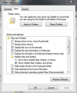

That is already checked, but I dont know where to locate the actual desktop.ini file to rename it etc.

They will show on your desktop. If not, run that fixer, select desktop and click fix. See if it will appear.
