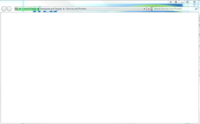

I work in a business environment. I have network and local machine administrator rights. Meaning, I have full control of everything. I ran into a problem a number of months ago where my Devices and Printers screen would appear, but then it would never load the devices. here is a screenshot of what happens.
Now I searched the net for some answers and I found an article that says that people have this problem when the Bluetooth service is not running. Well I started mine and the same thing happens. I logged into a different user i created on the same machine, and initially the Window comes up fine, but later on it does the same thing.
This happens both on a Windows 7 32 bit setup and a Win 7 64 bit setup.
Well, I finally found the source of the problem, at least as far as I'm concerned. We use McAfee Encryption for PC and Encryption for Files and Folders. It's only when I install the latter of the two that the issue occurs. The latter of the two btw, is a policy that forces encryption on any USB storage device inserted to the PC. So you are thinking "Great, report it to McAfee." Problem is, I did, and they tried to replicate the situation and they cannot. We ran down the list of options that we both had running and they were and are identical.
