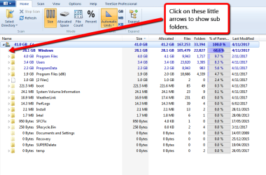

Well, I should elaborate. When I command examination of Drive C, Tree Size gives a report for my that says
"This folder: Size 91.4 GB" and
"Drive: C:\ Size 287.1 GB" and
Name: C:\ Size 91.4 GB"
Duh? Makes no sense.
So I've told it to look at Drive C. What's this about a "folder"? TreeSize can't seem to make up it's mind how big C is.

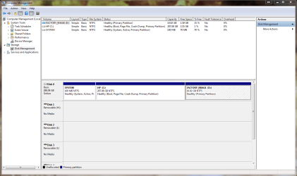

Nope. Not partitioned. The OS says disk C: is "4.60GB free of 287 GB".
See capture attached.

Thanks for that screen shot, but you did not include the full width of window to show the percentage free etc.
When you used Tree Size did you click on the little arrows on the side to expand the folder to show the sub folders. Like I have shown in these screen shots.
Click on each of those arrows where the folder size is fairly large.
If you use Hibernate it will take up a lot of disc space & check the size of the Page file. Also check to see if you have a lot of Restore Points as these can occupy a lot of space if you have a lot of them.

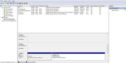

OK, see attached. Are we really getting any closer to a solution here? I don't see any evidence for large (200GB-ish) blocks of disk usage.
Why isn't your HP C: Drive being shown in Disc Management. All that is showing is Disc 5 with 300 Mb & another partition called Backup G. This drive also appears to be a UEFI system installation, whereas as your main system looks like it's the usual Legacy MBR installation.
The HP C: Drive is mentioned in the specs at the top but is not listed in the lower section. We need to see that to see what is happening there.

Disk C is listed in the management panel. It's right there, showing 287.08GB. But the snip didn't scroll down and get all the drives at the bottom. I removed the G drive, and this Disk Management pane now shows everything. Disc 0 (C) is the boot drive, and the issue is that it SAYS it's almost full. As you can see from the TreeSize, it really only has ~90GB of stuff on it. Something unidentified is sucking up 200GB of disk space!

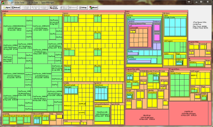

Yes, there is something huge hiding on my disk that Treesize just can't see. In principle, if I can see it, I can delete it!
OK, here's the result from Spacemonger. I'm not completely sure how to interpret the panel it produces, but it looks to me like Windows logs have a whole lotta stuff in them. Cbs and winxs? Can someone interpret this for me?

well according to your last post
Hibernate is still using space
and my guess re CBS is right
(CBS persistant logs are compressed but can be deleted but not recommended)
(i also suspect that hidden SYSTEM folders ie crashdumps are not being shown)
You did not answer my question re updating.
reckon there was a major problem at some point
is this purely >>> your user system <<< (read your other posts re remote usage)
