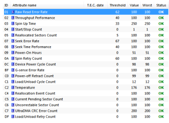

It failed short drive self test (Seagate), passed SMART, still testing. Ariolic it passed and says ok, but it mentioned some bad blocks.

As Roland mentioned, its best if you assume your hard drive is about to die. It may have no bad sectors despite that. Also do start > run > cmd > enter > sfc /scannow > enter. Also run a full virus scan.
