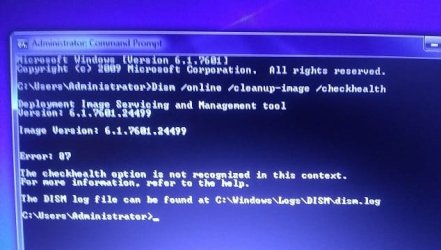

The only one that will run is DISM /online /cleanup-image /scanhealth
/checkhealth and /restorehealth result in the same context error.
I tried some other spellings and spaces, but there's something else that I am unaware of.
All the online "context" I have searched for is the same as what I have attempted here.
Is there another version that wants to see "...... /cleanup-wim /checkhealth" perhaps ?

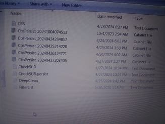

The other cabinet files are recent SFC scannow or DISM /scanhealth that ran to completion (with some errors that could not be repaired). See below
I'm still trying to learn what "persist" means, otherwise something to do about video screens or drivers has been my best Latin research guess.

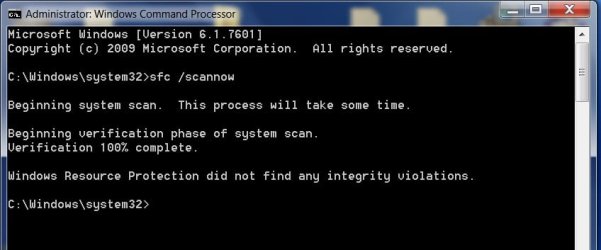

Anyway, my W7 appears to be running OK, but SFC will report a corruption somewhere none the less.

That KB runs as a one-off, used as and when required, so never appears in the installed update folders
MS decided many moons ago that certain folders needed to be kept during Disk Clean-up - windows update operations, they achieved this by labelling them Persistant

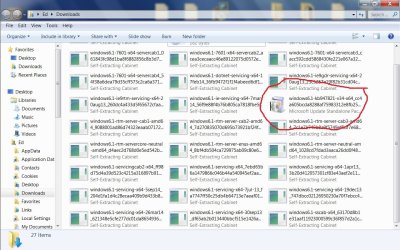

This is the SUR-Tool KB947821 that was offered for download :
There is one (1) 947821 executable standalone "SUR", and 25 other self-extracting cabinet applications.
Was I suppose to run all 25 cabinets, and then run the SUR tool ?
Well, Sysnative only mentioned about running the SUR. So I only did what was specified, and did not bother the other 25 cabinet applications.
After running the 947821 standalone, the CBS log continues to fail packages, but does not report the autochk.exe or display.dll.mui corruptions anymore. SUR may have repaired those two files - but - cannot fix the error failures to open or repair update packages.
I'm just guessing that the 25 cabinets need to be run and extracted prior, so that the SUR tool can open and/or identify them as packages ? ?? Maybe like the fuel and engine analogy you were hinting on...Yea...
