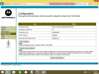

Modem is a Motorola SB5101
Wireless Router is a Belkin F9K1009v1
Wired Router is a Linksys BEFSR41 v4.1
When I said I have factory reset the router twice I meant once via the reset button on the back, and once via the internal configuration page.

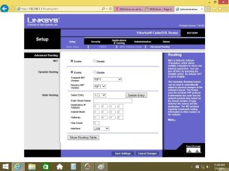

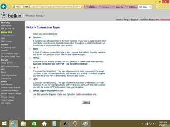

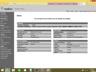

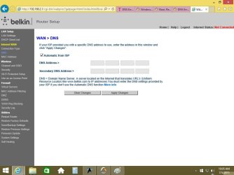

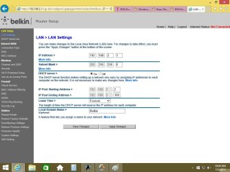

Screenshots of the routers configuration pages attached

Is there any place in the Belkin's interface that tells you what the IP address is coming from the modem? Some info that will answer the question in post #3. If not, try the old Linksys router and look for that IP address.
Reason:
The cable modem might might not be giving the Belkin or the Linksys an IP address.

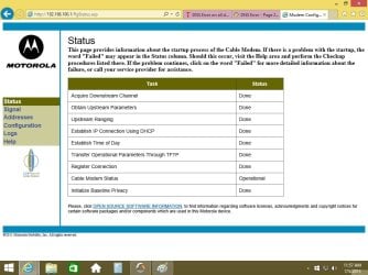

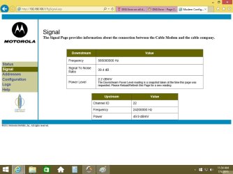

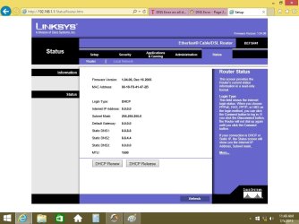

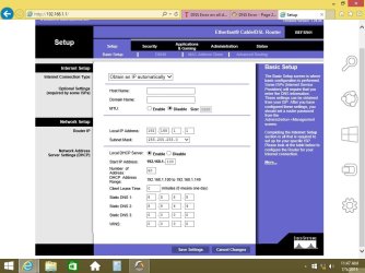

Linksys and modem screenshots.

That seems to indicate that the Linksys is not getting an IP address from the cable modem.
Plug the computer into the proper jack on the Linksys.
Plug the cable modem into the wrong jack on the Linksys.
See if the computer gets an IP address like the one in post #4. If it does, then the circuits that auto-sense jack types have failed on the modem.

Connected Computer to correct jack, modem to wrong jack, no change in IP
Debating a factory reset to the modem

Excuse me if the next 2 steps seems dumb, have to make sure as this is crucial.
-- Looking at Google Images, your Linksys router has it's WAN port labeled as "WAN". Use that port, and not "Uplink" or the numbered ones. And it is upside down with respect to the others.
-- Belkin has it's WAN port colored BLUE (labeled WAN), use that one to connect to modem.
- If you are indeed using the correct WAN ports then change the Ethernet cable between modem and router. Do this regardless of if you get IP when connecting PC through this very same cable.
- You may need to restart Belkin after connecting to modem (should be automatic but never know), Linksys you can just click "DHCP renew" on Status page.
I am holding my idea of factory reset as:
1- You already did twice
2- 2 routers failing same time is slim
