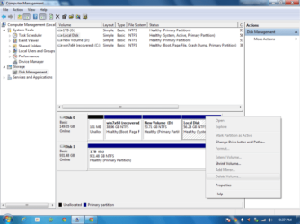

i am having a 150 gb hdd with windows 7 64bit on it, i have 3 partitions in it,now i baught a new hard disk so i want to make one single volume from the full 150 gb, i was able to delete one partition but another one is not showing the delete option please help :)

i installed windows 8.1 on the system, active partition and windows 7 on another one then i did not want to use windows 8.1 so by inserting the windows 7 dvd i formatted the partition in which windows 8.1 was installed after that the installed windows 7 did not show up ( it was showing BOOTMGR is missing) so i installed another windows 7 in another partition and then the old windows 7 also booted then from the old windows i formatted the partition in which the new windows was installed "the system reserved partition was not allocated from first, and was empty", now i want to use only one partition which has the total 150gb rather than using three different partitions with 50-50 gygs:D
Mmmm. You've seemed to created a bit of a mess.
Here is what I see: The partition "Local Disk" - the one that is highlighted in your screenshot above - is the ACTIVE partition, and contains SYSTEM files.
You can't delete the only ACTIVE partition from a disk running Windows - particularly while Windows is running.
This is also the partition the BIOS looks for when looking for a hard drive to boot.
Further complicating things is the partition "Win7x64(recovered)" contains the BOOT files and the PAGE file for the system. The BOOT files are the files that actually start Windows when the BIOS hands off. If there are no BOOT files then the operating system will not start.
So the question is: do you want to try and keep the current W7 installation, or would it be just as easy (for you) to do a fresh clean install to clean up the mess?

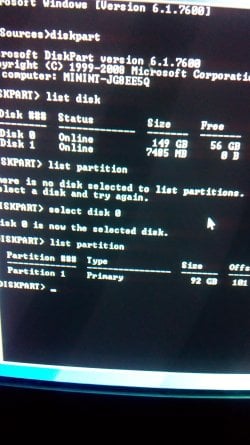

when i try to open the system recovery options it shows “This version of System Recovery Options is not compatible with the version of windows you are trying to repair. Try using a recovery disc that is compatible with this version of windows.”
and i deleted the second partition from diskpart now i only have the partition in which windows is installed

Hi subhranshu50. Sorry, it is a holiday here in the states, and I am on Turkey duty.
I re-read the thread and it occurs to me that with all of the uninstalling and reinstalling - You installed W8 and W7, then uninstalled W8, installed another W7 for a total of 2 W7 installations, that you may have a knot that can't be untangled (read: time for a clean install).
Now we have succeeded in deleting one of the W7 partitions, leaving 1 installation, but the system can not boot to that installation.
And System Repair does not recognize the remaining installation as compatible with the disk.
I assume you are using the same disk to run System Repair that you used to install W7?

i guess this is happening because the windows that i have is updated to sp1 but the cd is a old one so i guess now i have to install a new windows thank you
