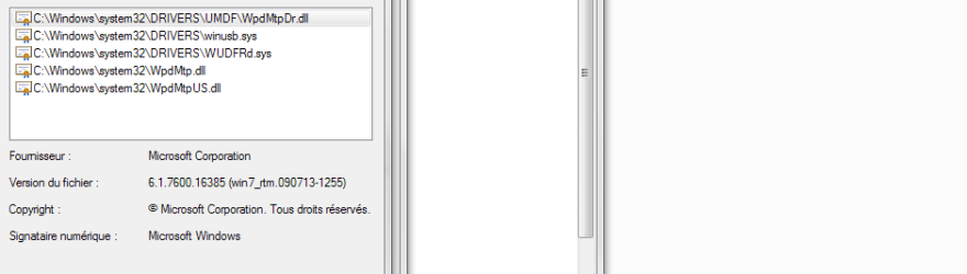

On the two screen shots, those are the drivers and most common .dll you should have to load your camera with MTP.
1st capture With only .dll refer to the folder C:\Windows\System32\drivers\UMDF
2nd capture is in the Device Manager.
