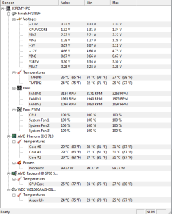

P.S. Attached are more detailed specs, I appreciate any help! :)
