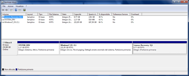

We need to see a screenshot of your Disk Mgmt drive map and listings to advise you on the possible boot partition conflict.
Thanks for the feedback. I enclosed a snapshot of the disk management, as it came from OEM (Sorry it is in Italian). As I said, no operations have been carried out up to now.
Thanks also for pointing out the Guide of Dual Boot Installation. I was aware of it, yet there is always the risk of messing up with the new WinXP installation the MBR-boot sector of Win7, that I would prefer to avoid.
If no WinXP installation is possible to external disk, as you say, would "My attempt" (See first post) be possible if at step 2, instead of an external USB disk, I would insert *another* internal SATA 2.5 HDD in place of the original, install WinXP in it and proceed with the other steps, i.e. "move" the WinXP file/folders from this disk to a new partition created in the original SATA HDD, which contains also Win7 Professional, etc.

I would use free Partition Wizard bootable CD to get a graphic image of your partitions with the listings on each, to confirm which is System and/or Active. The other method uses a lot of line commands and is harder to interpret.
Whichever imaging app you use will allow you to make a boot CD in case it doesn't want to reimage from the program in Windows. So burn the boot CD to make sure you have a backup method to reimage.
