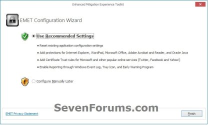

I'd have to agree with you on that as well. It sure seems like EMET is blocking or doing something to not allow them to run.
Brink
Did anyone figure out how to know it is working?
That is "turned on".
I read your directions 3 times and the pdf 3 times.
I set per your instructions and all software so far functions.
I set "Configure System" to max and rebooted.
This is what I'm showing- bottom Snip. Running EMET column is empty- totally.
"System" has a question mark as it always has since install in December.
I thought I would take a look at EMET since the SP1 update and I'd see if this was working or not. Still haven't a clue. :confused:
Mike
Also
Copied this from your post #1. Where is this window?
Typed Performance Options in Search and found nothing.

Hello Mike,
From your screenshots, EMET is working properly. EMET will gray out the DEP settings in the top screenshot since EMET is being used. You can go through the EMET User Guide from the link in the tutorial for detailed information on how it's suppose to work though.

Hi Mike,
That's in advanced system settings, performance box, settings.

Thanks Derekimo and Brink.
Found the window.
DEP tab selections are grayed out as you said it would be so I guess everything is working properly. ;) :D
It just would be nice to have something showing so you know the EMET was definitely active and working properly. LOL
