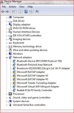

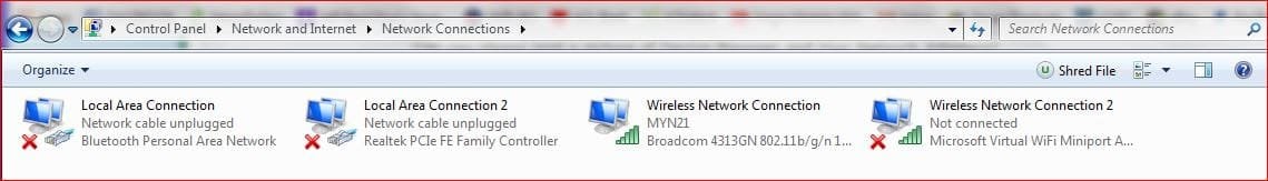

Attached are the pic of the DV showing the problematic adapters and networks
I did a diagnose of 2 of the networks that have the red x, they said I need an ethernet cable. Never before have I needed that. I have a simple laptop PC with wireless connection, I don't think I need LAN. I thought is was the adapters causing the problems.
Hope I did the pics correctly.

no connectivity is fine
