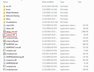

there's one additional file called userenv.dll, no idea what it is.

Hi Freecom,
can you check the permissions on that, and oleacc which i also dont have UNDER this location.
mine are in system32 and winsxs.
Would you also check your AV logs and see if they have blocked/quarentineed anything
Roy

umm... wow. this picture i have attached explains a lot lmao. now i feel like a flipping idiot.
i think i had COMODO block this process a long time ago because it kept running up my CPU for whatever reason. used to actually share media between my computer and Xbox and occasionally some other computers in my house, but when i stopped doing that it still ran up the CPU, which was pretty annoying. i'll try unblocking wmpshare.exe and see if that makes the update work. (EDIT: still can't change ownership of wmpshare.exe to administrators after unblocking it - says access is denied.)
as for the permissions:
  • oleacc.dll: everything allowed on SYSTEM and Administrators, read & execute and read are the only ones allowed on my account. which doesn't really matter, since i'm the only account on my laptop and it's admistrator. went on Google to look up what this does, apparently it's used for Windows accessibility options or something.
  • userenv.dll: same thing. used for managing user profiles, apparently.
COMODO has never picked these up as any sort of malware on any of the times i did a full scan, and i have it on a pretty high security setting.

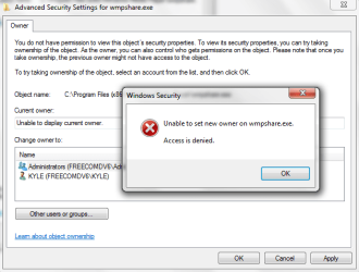

i edited my last post, but the edit was short and not very noticeable, so i'll just type it again. even after unblocking it from COMODO i can't switch ownership of wmpshare.exe to me so that i can set permissions.

Wouldn't worry about the ownership, its not important as long as your security updates are installed.

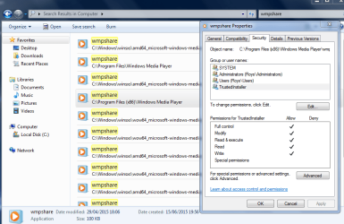

Any way been reviewing my previous comment re the permissions on WMP, which is what is killing WU according to the log.
in the screenshot you posted it stated
Unable to list current owner
IT should be showing Trusted installer, see screenshot front page should be like mine.
Also showing in the WUlog were updates to Microsoft Security Essentials, thought you were running commodo or is it just thier firewall?.
Roy

Hi Freecell,
Its attached now. just stick that desc in seach > then more if it doesnt turn up.
I didnt actually think MSE works once you put another AV on it switches itself off

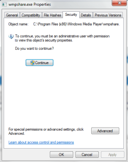

this is what my security tab looks like for wmpshare.exe.
when i click that button, it takes me to the Advanced Security Settings window from the last time i posted a screenshot.

Can you try typing in TrustedInstaller, instead of you

apparently not.
