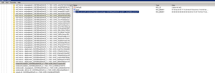

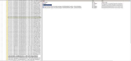

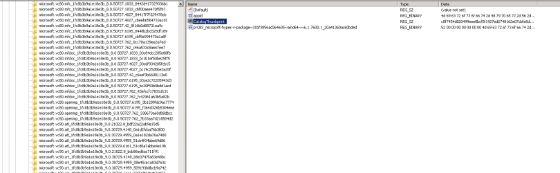

Also here are the subkeys from CanonicalData\Deployments of the two manifest files:
p!CBS_microsoft-hyper-v-package~31bf3856ad364e35~amd64~~6.1.7600.1_20a41360ac60bded
p!CBS_microsoft-windows-foundation-package~31bf3856ad364e35~amd64~_669c8c63b48c8ee1
p!CBS_microsoft-windows-foundation-package~31bf3856ad364e35~amd64~_56a20b8cc2231cf7
There are three of them as the second manifest had 2 subkeys, one for version 6.1.7600 and the other for 6.1.7601. Please see attached pictures of the registry as well for further confirmation. The tool's log files are named FRST and Addition.
Thanks again for your help with this!
Alex
