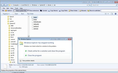

I can't open my hosts file. i want to block websites. when i right click on the hosts file to run as administrator i get http://postimg.org/image/m5pmiw45n/. I cant open windows defender. When i click on it i get error message

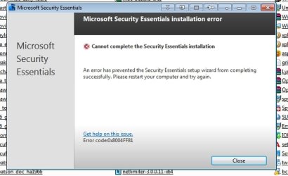

i can't install microsoft essentials. this just happened recently when i had a virus or malware that's removed now.

It might be that you have install a fake MSE. Please read this but do notheing until I can locate a expert.
http://www.geekzsupport.com/error-code-0x8004ff81-microsoft-security-essential-installation-failed/
http://answers.microsoft.com/en-us/...on-error/f05d5b19-b3a9-4b8a-86f5-412840298269
Keep us informed on results.

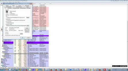

What programs did you use to remove the infection?
autoruns, process explorer, emi soft anti malware and an online anti virus scanner, house calls i think.
What infection was removed?
there were 2 or 3. 1 was wscript.exe
Where did you get MSE from and how.
the same place as ur link. how? i clicked on the link in ff.

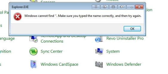

Start Orb and type in Defender.
Make sure Defender is off.
defender is off. when i type in defender in the run box i get this error.

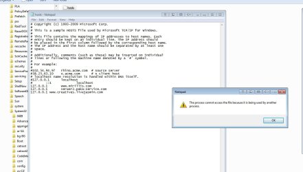

this is the error i get when trying to change the hosts file.
custom build. puget 2600k
intel i7
asus p8p67 pro
ddr3 dual 8gb
nvidia geforce gtx 570
6 external hard drives 1tb -3tb, 2 internal - ssd intel 520 series and 1tb western digital
none
ff,ie

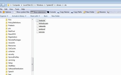

Let's see if flushing the DNS cache and restoring MS Hosts file will help.
Copy and paste these lines in Note pad.
@Echo on
pushd\windows\system32\drivers\etc
attrib -h -s -r hosts
echo 127.0.0.1 localhost>HOSTS
attrib +r +h +s hosts
popd
ipconfig /release
ipconfig /renew
ipconfig /flushdns
netsh winsock reset all
netsh int ip reset all
shutdown -r -t 1
del %0
Save as flush.bat to your desktop.
Double click on the flush.bat file to run it. You may need to right click the .bat file and choose to run as Administrator.
Windows 7 Ultimate 32bit SP1
INTEL/D975XBX2
ATI Radeon HD 2600 Pro
Samsung SyncMaster 914v
1280 x 1024
One is not connected
Rocketfish 700 W
G.Skill Gigabyte Chassis
Standard PS/2 Keyboard
Microsoft PS/2 Mouse
DSL
Avira Internet Security
IE 11
ATI HDMI Audio
Done. the pc restarted. i went to the windows\system32\drivers\etc folder and it's different. i don't see the hosts file that was there.
Copy/paste the Hosts.txt
