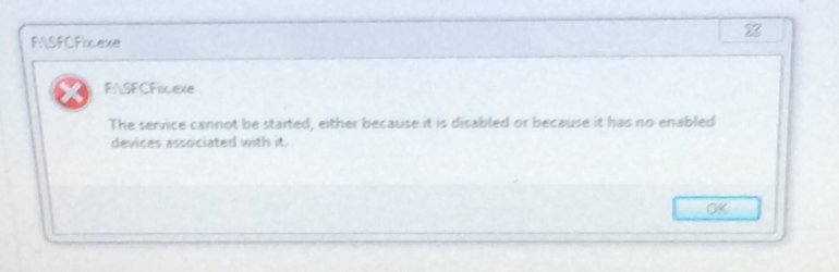

IMG_1738.jpg This is what happens when I use the file...

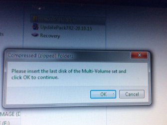

This is the error i received when try to open up the os file you let me use IMG_1748.jpg
64
Weird
Downloaded and opened it with WinRAR works perfectly.
How are you trying to open it?
Double-left click?
With what compression/decompression program?
You can try 7-zip to open zip/compressed folder.
Download - 7-Zip
Here's a link to the Win7x64 ISO.zip
You can extract the ISO contents to a folder with 7-zip
I create a folder and extract to there so that you don't end up with multiple folders in the location you choose.

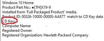

My email notification indicated you have a question about obtaining your 25 character product key.
If your Win7 is factory installed it should be on the case of a desktop, or on the bottom or in the battery compartment of a laptop.
You can use Magic Jellybean to find it from within your Win7 installation.
Magic Jellybean. You want CD key, not product ID. I usually copy and paste to notepad, place the file on my desktop & also print it. If you don't have the key you will not be able to enter it and activate windows.
