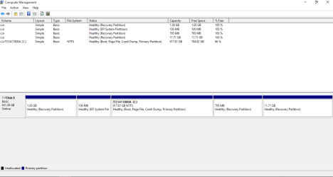

What I'm trying to do in polite way is see how the Disk Management is before any more registry changes are recommended and made.
I know exactly what Malwarebytes and SAS are and how they work. I have use them for years.
They seldom cause any problems but AVG does cause problems often.
I do believe if the partition letter (D) on the Reserve partition could be causing problems.
I would like a look see of Disk Management before giving instructions and recommendation.

Disk Management looks as below.

Hi Evelyn,
To be honest, I can see where Toshiba is coming from as the problems you're experiencing are most probably software related, and as you upgraded it from what they sold you, you take the responsibility.
What I don't agree with is Microsoft screwing everyone over because they cause massive problems with their buggy OS and refuse to deal with it (I had a friend who updated from Win7 to Win10 and was stuck in a BSOD loop, he couldn't even get into safe mode because Microsoft disabled the F8 key shortcut to make it boot faster 😂 and I had to fix it).
Anyway, did you always have so many partitions on your HDD?
