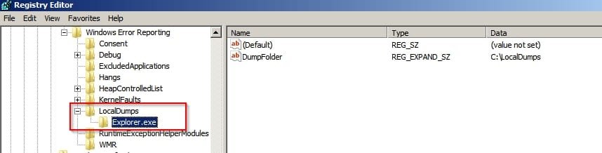

See: Windows Explorer crashes when trying to open certain file properties
Here's the reg file: View attachment 394194

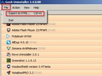

Also list installed software. Run a copy of free Portable Geek Uninstaller
Save a list of programs to file and zip the file and attach it when you post here.

just looked at said thread, lm assuming by creating a backup of said key l can uninstall by re-running the reg file l previously saved?
In theory you can just delete the LocalDumps key and subkey to undo changes but a backup is always a better plan.
It just creates an entry to produce explorer specific crash dumps and place them in C:\LocalDumps
It doesn't actually do any harm to leave the registry with the new entry once created though.

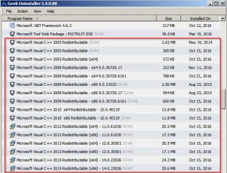

Okay it indicates a problem.
1) msvcr90.dll
Suggest - install and update MS Visual C++ Runtime. Could you list versions as show via GeekUninstaller?

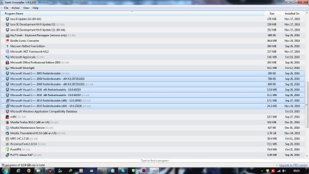

so its C++ runtime related?
attached what l see.. what do you suggest l do? uninstall all? then reinstall? if so it would be useful to be directed to the safest place to grab them as l dont think l was offered these through MS update, its possible some were bundled with software l use. (been reading suggestions both 32bit and 64bit runtimes should be installed on a 64bit OS could that be part of the issue)

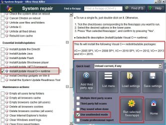

That just looks like the standard set that you get via windows updates. I would suggest uninstalling them one at a time using GeekUninstaller including the "scan for leftovers"
Then if you like you can use UVK (installed or portable) to reinstall them in one go.
Link if you want to try: UVK - Ultra Virus Killer
Ignore license message. It's free to download and use.
Form Welcome Screen choose "System Repair" and locate the VC++ fix in the left pane and run it.
