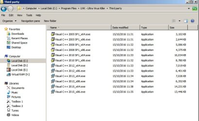

RE: 2015 runtimes. That's odd because I find them here:
C:\Program Files\UVK - Ultra Virus Killer\Third party
Access Denied

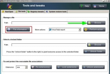

though l am curious, does UKV add extra context menu options to right click? l recently noticed force delete and file information options when l right click files and folders, no idea where it came from and l havent exactly installed anything apart from program and windows updates for stuff lve already got installed. be nice to get rid of the options seeing as l need a licence to use them.

RE: UVK context menu entries. You can get rid of them but the "Force Delete" option comes in handy sometimes.
Anyway here is a UVK script to remove them. Download the zipped file and extract it and run it.
Altenatively launch UVK and choose "Run Scripts" from the Welcome Screen and then "Import Script From File" then browse to the extracted file and run it.
Contents of file:

RE: UVK right click context menu "File Information" - you don't need a license to get the report. Just launch UVK and choose "Tools & Tweaks" then swith to the "File Tools" tab then browse to the file that you need to check.
RE: UVK Force Delete right click context menu. You can Force Delete files using your own scripts or else via the "Delete Files & Folders" button on the Welcome Screen.
