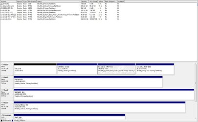

I have been messing around with partitions for a while now, but have never tried to extend or change a C: partition before. Now I find that I need more space on my C: partition, but, unfortunately, the partition is to the right of the space I want to extend into.
So, I tried method 2 of the tutorial provided on this site, and it didn't work saying that I didn't have enough space. I've downloaded MiniTool Partition Wizard, but I am a bit nervous here.
First, is it safe to do anything with the C: partition? I mean...it is in use while the OS is in use. It is the active/boot/system partition on that drive.
Second, is there a way to physically move the C: partition to the left/ first spot on the drive?
I guess I just don't quite understand how partitioning operations work, even though I understand what a partition is. Since I have a new, 2TB drive, and will be getting another one soon, I'd like to make the whole HD that my C: partition is on, into one big C: drive, since I no longer need to share it for other things.
Anyone have advice on this?

Please post back a screenshot of your full Disk management drive map and listings, using Snipping Tool in Start menu. We can give you the steps to extend C to the whole HDD if this is what you want.,

Ok, so I have not wiped the two other partitions on this drive yet because I am still moving files around, but I had wanted to go ahead and add unallocated space to C: now, and the rest later. I am not averse to using the methods described by BF Kid, but I am trying to understand more about partitioning operations involving the C partition, and mostly what NOT to do.

I'd start by booting PW to rightclick delete G (after backing up its files),
then rightclick Resize C, drag its left grey border all the way to the left to take up the unallocated space, OK, Apply.
Have your Installation DVD or Repair CD standing by in case you need to run Startup Repair to repair the System MBR since resizing will occur on the boot sector: http://www.sevenforums.com/tutorials/105541-startup-repair-run-3-separate-times.html

I have a question on another subject; are there bootable Operating System(s) on the other Disk #s 1 & 3 as I see from the snip they are marked "Active" and that may cause other issues if they are just data drives.
Disk 1 is the drive that is used to run programs like games. The only OS (now) is on disk 0. Disk 1 is games and large programs. Disk 3 is storage for a lot of data like movies. I do not know why they are both marked active. I do not remember ever marking them that. Perhaps because they had paging files on them at one point? I have shifted paging files around several times.

It would be a good idea to mark them " Inactive " from an elevated command prompt so they don't cause future issues; have a look at this snip below for the steps, obviously you would substitute your specific disk/partition info.

Thanks. I actually finished freeing up all of the data on the harddrive with my OS on it and did everything with the partition program as you guys had suggested. While I was in that CD-ROM screen extending my C: drive, I went ahead and marked every disk inactive except C:. After I did all of this, I rebooted with the Windows repair disc in that I had made. It said no errors were found, so I rebooted without it and everything is working perfectly now, thanks to all of you guys' advice.
